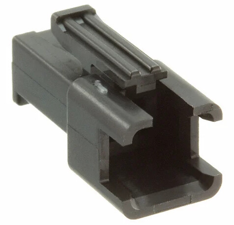

Assuming you are correct that it’s a 10K thermistor, here’s a subset of our 10k thermistors with a ring terminal lug clamped around the thermistor and leads attached. If you can narrow down the beta value, that would help to narrow down the list even further.
As a note, based on images I saw, it looks like the connector attached to the Jura Z9 temperature sensor is probably the JST SMR-02V-B, which requires the SYM-001T-P0.6(N) contacts.
