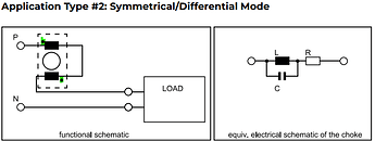

It depends on the use case – this part consist of two CMC (COMMON MODE CHOKE) and as
Application type #1:
Symmetrical/differential mode in parallel configuration the Inductance is specified with 14µH and whereas
Application type #2:
Symmetrical/differential mode in series configuration the Choke is specified with 56µH – even when being marked with 14µH. To calculate the inductance we will need to find AL the formula is (AL = H x turns²). So, “14µH x 2² = 56µH”
