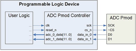

This details a VHDL component that handles interfacing to the Digilent’s ADC AD7476A Pmod, shown in Figure 1. Figure 2 illustrates a typical example of this ADC Pmod Controller integrated into a system. As shown, the ADC Pmod Controller connects to the Pmod ports and executes transactions to secure ADC data from each of the Pmod’s two ADC channels. The data is then presented on two simple parallel interfaces which can be connected to user logic or to output ports on the FPGA.

The ADC AD7476A Pmod uses two of Analog Devices AD7476A 12-bit analog-to-digital converters to provide simultaneous A/D conversion at speeds up to 1 MSPS. These ADCs are wired on this Pmod to share chip select and serial clock signals. The appropriate application of those signals initiates conversions and controls the flow of serial data from the Pmod.
Theory of Operation
The ADC Pmod Controller uses a modified version of the SPI Master component available on eewiki to continually initiate readings and retrieve the resulting data from the ADC Pmod. Once complete, the received data is made available on adc_0_data and adc_1_data ports. The controller then waits for 50ns and restarts the process (the ADCs require a 50ns quiet time between conversions). This results in continually updated ADC data available to the user with no input required.
The SPI Master is configured with CPOL = 1 and CPHA = 1, to meet the requirements of the AD7476A converters. This SPI Master component was modified to add a second MISO channel that operates as a direct duplicate of the first channel.
Equation 1 defines the frequency at which the output data updates. This is influenced by the system clock frequency the user provides at the clk input port and the value assigned to the spi_clk_div GENERIC. (See the section Configuring the Clock for details to properly assign spi_clk_div). All frequencies are in MHz.
The ADC Pmod Controller is set up to provide the fastest update rate available for a given system clock, while keeping the serial clock rate within the 20 MHz specified upper limit defined in the AD7476A datasheet. The fastest update rate is achieved when the system clock is an integer multiple of 40 MHz.
