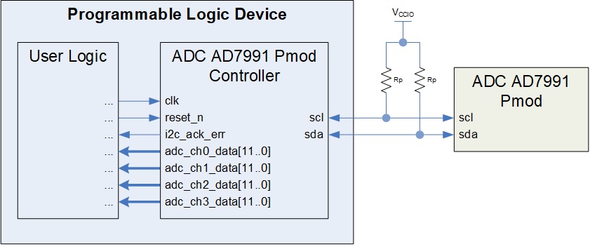

This details a VHDL component that handles interfacing to Digilent’s ADC AD7991 Pmod, shown in Figure 1. Figure 2 illustrates a typical example of this ADC Pmod Controller integrated into a system. As shown, the ADC Pmod Controller connects to the Pmod’s I2C ports and executes transactions to gather data from each of the ADC’s 4 converter channels. The data is continually updated and presented on simple parallel interfaces which can be connected to user logic or to output ports on the FPGA.
Figure 1. Digilent ADC AD7991 Pmod
Figure 2. Example Implementation

I2C Pull-Up Resistors
Unlike most of Digilent’s Pmod boards, the I2C pull-up resistors shown in Figure 2 above are not included on the PmodAD2. The I2C bus will not operate correctly without them.
The user can solve this problem by wiring 2.2 kΩ resistors into the circuit as shown.
Several of Digilent’s other Pmods use I2C, include these resistors, and also include connectors to plug additional Pmods into the same I2C bus. If this ADC Pmod is used in conjunction with one those Pmods, the user can automatically take advantage of the pull-up resistors already included on those boards and no further action is needed.

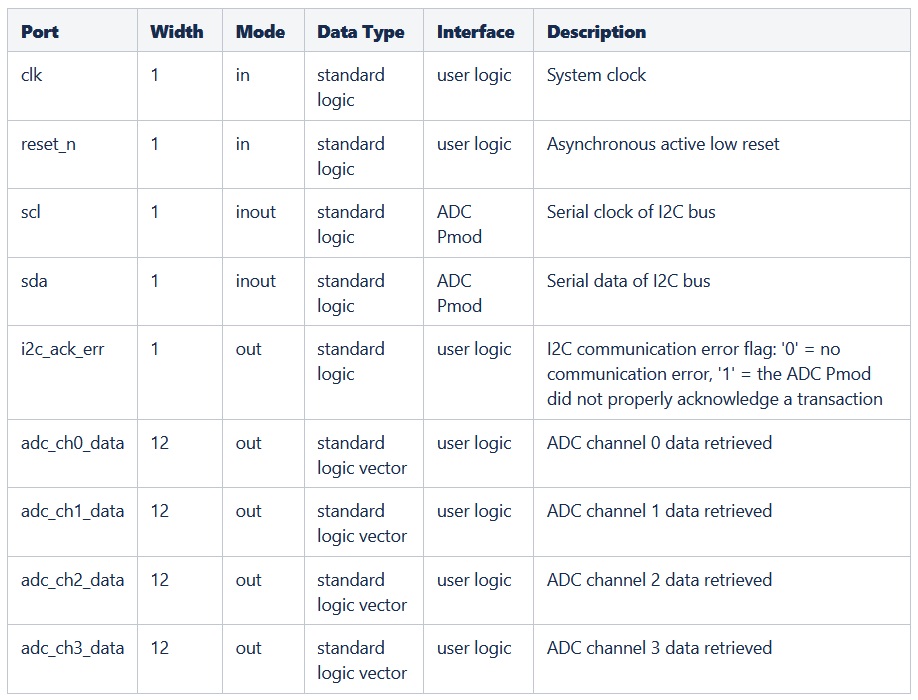

Port Descriptions
Table 1 describes the ADC Pmod Controller’s ports.
Table 1. Port Descriptions
