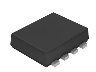

I am hoping someone can help me figure out a part number for this component or something else that might be compatible. Unfortunately, I do not have the schematic and the original component has a bit of a burn mark on it. All I could read was V108 on the top line. The second line which perhaps was a date code was not legible. After trying to clean the burn make with Iso, even the top line is not quite readable anymore in the photo :grinning_face:.
There was a dot to mark identify pin 1 (bottom right corner of the sketch). The dimensions of this component are approx. 2.85mm wide x 2.35mm high.The package appears to be flat with no gap between the PCB and the component and I do see some solder but no real legs sticking out the sides. It is 8 positions (4 on top and 4 on the bottom).
Vin in this application is 5VDC and Vout is 3.3VDC. Any of the pins that I have identified as Vin could actually be an enable or other type of input that expects the same voltage as Vin for the converter to put out the 3.3V.

I need to know the case type of chip.
To do this, you need to unsolder the chip and show the bottom.
I also need a photo of the contact pads on the board after unsoldering the chip.

If I understand correctly, the case of your microcircuit is TSMT8.
Thanks for identifying the package type Adam. It certainly seems to look right. I had tried to look up the package but was unable to find it. Is there some document or website that you use to find the package type?

Very interesting case.
I can’t find any microchips in TSMT8 package.
TSMT8 package contains only MOSFETs.
Maybe I made a mistake in defining the package?
Definitely need to sketch out a diagram.
I am pretty sure your identification of the package is accurate. I checked the thickness as well just now and it is 0.8mm so in line with the dimensions you provided. This PCB was manufactured in July of 2014. The second board that I have with a different component and layout was manufactured in April of 2018. So my guess is the original component is an older component, possibly from Rohm because of the package type and because the newer one is most likely also from Rohm. However the older one I am looking for is perhaps too old and out of production.
