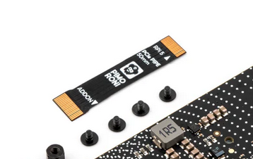

My Pimoroni Dual NVME Base (1778-PIM704-ND) started to not working since yesterday and i already Diagnose by
lsblk
lspci
And using RaspiOS, all the firmware is already up to date by
sudo apt update && sudo apt upgrade -y
sudo rpi-update
sudo rpi-eeprom-update
And from my
sudo nano /boot/firmware/config.txt
i’ve uncommand
dtparam=pciex1_gen=3
After a few hour the PWR led were turn off , so i might think that the flex cable were the problem
Then ive started to play with the bending , there’s certain times the PWR is on
The original part from Pimoroni didnt have the delivery to Malaysia :frowning:
Is there any product that can replace the flex cable?
Is the 1528-5931-ND is compatible to the 1778-PIM704-ND although it have a curve?
Can you please take a photo of the current one, every pi5 pcie adapter seems to have a slightly different shape…
One option: https://www.digikey.com/en/products/detail/adafruit-industries-llc/5930/24614915
Another: https://www.digikey.com/en/products/detail/adafruit-industries-llc/5931/24614904
So we need this a straight cable:
Based on this: PCIe Flex Cable for NVMe Base and Raspberry Pi 5
This would match: https://www.digikey.com/en/products/detail/pimoroni-ltd/PIM711/26242691
