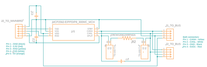

@rick_1976 Yes, the scope is out and I’ll be doing just that. I am concerned though that the way I added the second Molex to the two connector board intended for ‘mid-node’ use in this network might not be correct.
I’ve gone ahead and popped in a screenshot of the PCB layout and if you have a moment to look it over and see anything just blatantly wrong, I would appreciate hearing that from you (or others). As I said, this board is based on the single connector board that works fine with the end points when the 120 Ohm terminating resistor is jumpered in.
I’m not asking for a full critique of the board (although I’ll take that too). I’m interested in if J1_TO_BUS and J2_TO_BUS are connected in a way that will keep them from working as a mid-node connection. My vision was that J1_TO_BUS connects to a cable going to end node A and J2__TO_BUS connects to a cable going to end node B. (J2_TO_MAINBRD goes to the BeagleBone Black). The board is 52 mm x 34 mm.

First impression of the layout is that the traces are very narrow with minimal clearance at a number of points. Very easy for that to result in things being connected that shouldn’t be or vice-versa, and also bad for signal integrity.
I’d check for rogue shorts/opens, add a ground plane, and fatten up the trace/space limits in a next revision.

I did connect the scope and CAN_L looks really good on the mid-node board. BUT, CAN_H seems to be riding down on a lower frequency (probably 60Hz) carrier coming from somewhere. In my experience that’s usually a ground issue somewhere. That riding down while CAN_L is stable is going to impact the differential. CAN is great for dealing with noisy environments but this is probably stretching it.

I reduced the bit rate to 125000 bps and the three node set up works. So I am redesigning the board to improve the layout so we can run at the higher rate. Lessons learned. Thanks!
FIXED! This issue all along has been capacitor C3. I misread the Microchip literature and thought that capacitor was supposed be installed from CAN_H to CAN_L. But it isn’t. I took that capacitor off the original boards and a three-node network is working really well now at 500Kbps. Looking at it now, it was obvious from the scope traces that a capacitive decay was involved as the two-node waveform has a decay and then adding a third node, thus increasing the capacitance, made the decay even worse. Duh. Shame on me! Live and learn.

You mention using the MCP2562 in your text and in your schematic, but the MCP2562 does not have the “SPLIT” pin shown in your schematic. Only the MCP2561 has that pin. The MCP2562 replaces the “SPLIT” pin with a “VIO” PIN, which should be connected to the VIO voltage supply of your controller device (looks like that’s the BeagleBone Black Rev C in this case).
It looks like you have that pin going to a pin on J2 labeled 3.3V, so that implies that it is connected correctly, but you might want to correct the label on pin 5 by labeling it “VIO” in your schematic to be consistent with the part number you are using.
