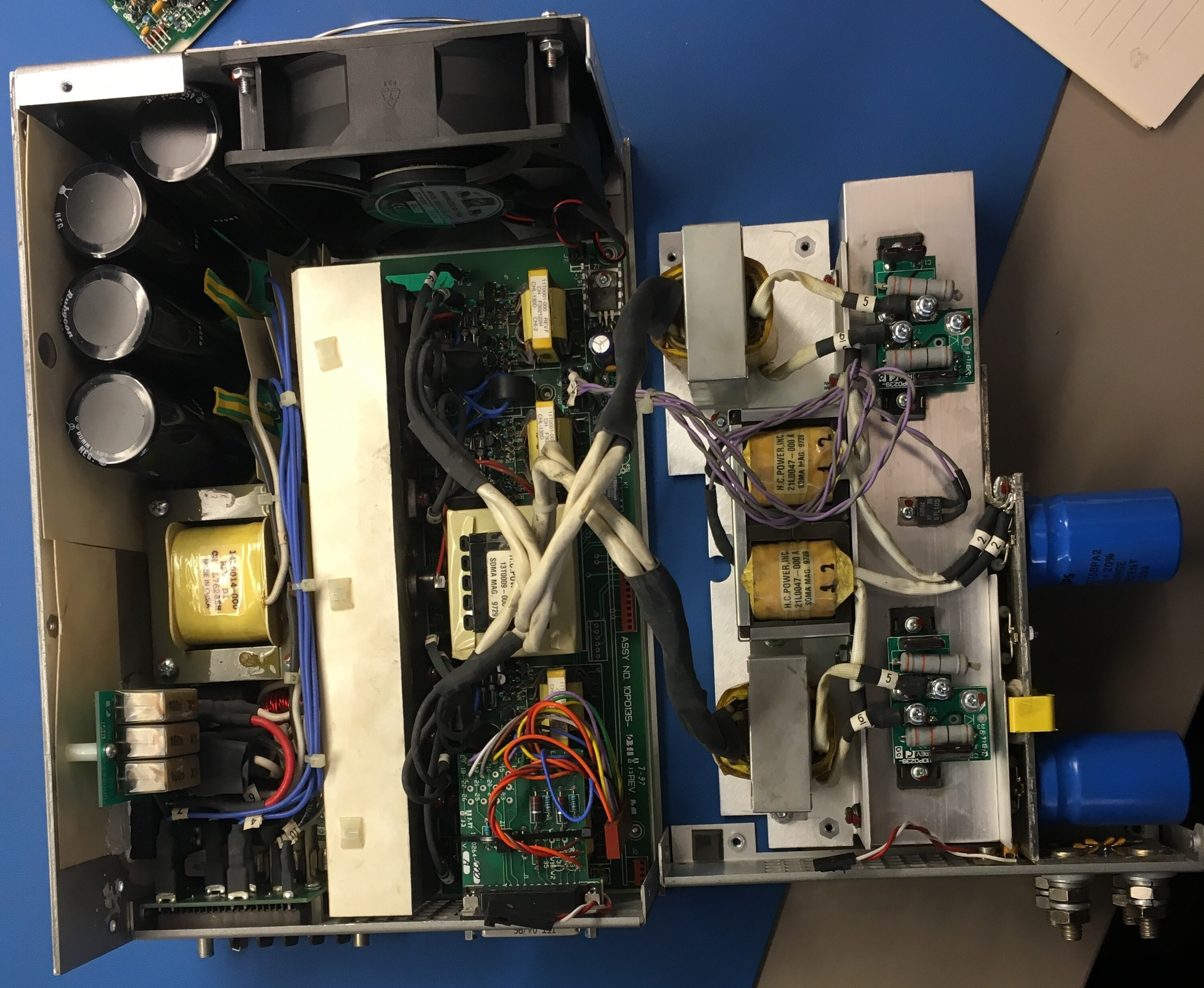

During a postmortem examination of one of these failed supplies, the first clue as to the cause of failure was evidence of arcing between the leads of what appeared to be a three-phase rectifier array, composed of a half-dozen Vishay VS-HFA16TB120PBF diodes, which are rated for 16A and 1.2kV and come in a TO-220 package All three of the 10A, 500V AC line fuses (having a 5x20mm format and shrouded in heat-shrinkable tubing) near the power entry point to the supply had been blown along with what appeared to be a DC link fuse situated further into the supply, and a number of the other diodes in the rectifier array were found to be faulted as well. Replacement of the diodes in this array along with the fuses restored this supply to basic operation; comprehensive testing was not undertaken, since the device would not be returned to service in any event.
Figure 5. Input half of supply with fuse chamber removed. Path of input power in 3-phase AC format across board is shown by red arrow, post-rectification in green.
Figure 6. The input rectifier array (right of the toroids) which failed. Photo taken post-repair.
Of the three identical (failed) supplies examined, all exhibited this same fault pattern, along with a large uninterruptible power supply not discussed here which showed similar symptoms suggesting an input overvoltage event as the proximate cause of failure.

Figure 11. The opened supply separated into its two major internal segments.
Opening one of these supplies for sake of comparison (there were twenty used, in a distributed massively-parallel redundant system) offered immediate insights on potential reasons for their superior service longevity. While not directly contributing to this longevity, the selection of internal fuse components suggests that the protection components were not an afterthought. Rated for 14A/500V, these comparably beefy 5AG format (0.406" x 1.5") devices are rated to interrupt up to 10kA at 500VAC. These were fitted into holders rather than being soldered into place.
Figure 12. Input section showing fuses, bridge rectifiers, and shrink tube-protected MOVs. X-capacitors for snubbing diode recovery are also shown.
Shortly thereafter in the input chain is the likely reason for these supplies’ service longevity: a trio of metal oxide varistors (MOVs) shrouded in heat shrinkable tubing and connected across the input phases, directly adjacent to the input rectifiers. These rectifiers were of a common 3510 class, having a nominal 35A capacity and listing a 1kV peak reverse voltage (700V RMS). Datasheet characterizations for devices of this type suggest that these figures include a bit of margin to their actual poof voltage, which occurs at roughly 1.1 to 1.2kV. The MOVs selected for use were reportedly a V480LA80BP, rated for a maximum operating potential of 480VAC and having an indicated clamping voltage of 1.16kV at a 100A current level, which is quite reasonable. Though bit of margin between the nominal line voltage and the rated operational maximum for the selected MOV would seem desirable to guard against the chance of conduction at the AC line peaks, a higher rectifier voltage rating would be required to avoid a resultant loss of protective effect, and precedent seems to indicate that the chosen device rating is adequate. The prevalence of non-power factor corrected electronic loads has a tendency to flatten the peaks of AC utility waveforms, providing what is perhaps an unexpected benefit in this specific case.
