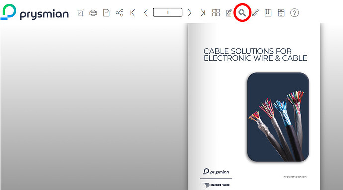

We are often asked for the colors of the conductors inside the multiple conductor cables from Encore Wire, such as the C0767A.38.10 (W520-500-ND). We can use the catalog to find this information. Click on the magnifying glass (in red below) to open the search box.
Entering the cable part number into the search box will bring up a list of pages that contain that part number (seen below for our example part number).

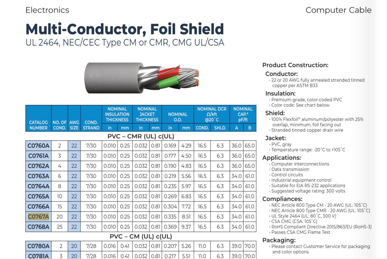

Clicking on the thumbnail will bring you to the relevant page (seen below).
Scroll to the bottom of the page to see the color chart (seen below).
Our example part number is a 20 conductor cable. By using the color code chart we can see that the cable would have the following conductors.
Black, White, Red, Green, Orange, Blue, White/Black, Red/Black, Green/Black, Orange/Black, Blue/Black, Black/White, Red/White, Green/White, Blue/White, Black/Red, White/Red, Orange/Red, Blue/Red, Red/Green

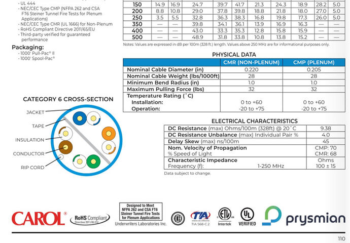

Some cables such as the CR6.30.07(CCR6BL-1000-ND) have a visual reference rather than a color chart (seen below) but you should be able to find the conductor colors of most Encore Wire cables using this method.
