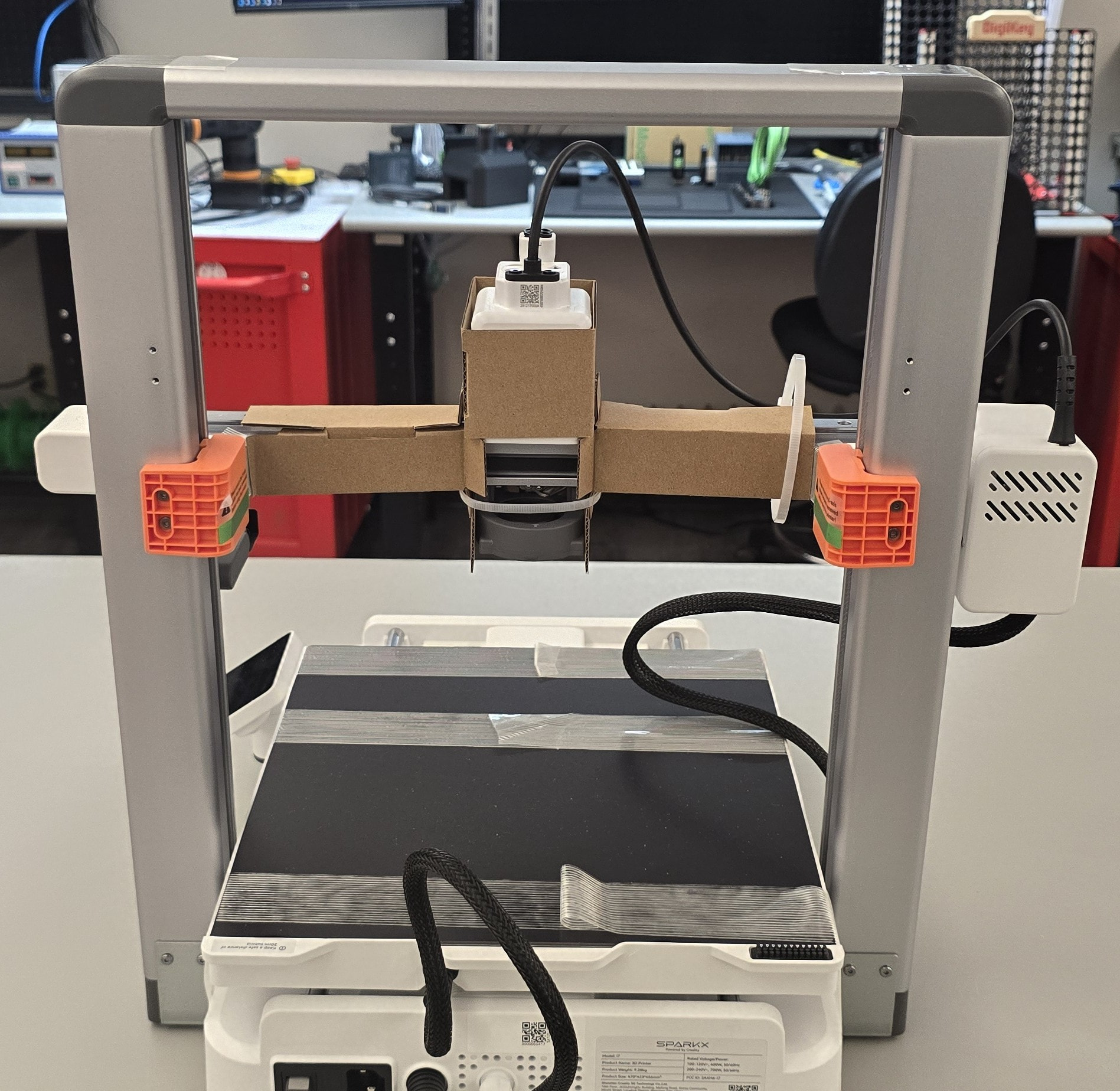

Looking at the Sparkx i7 from the rear, there are 2 orange brackets that hold the X-axis in place for shipping.
To remove the brackets, use the 2mm hex wrench (the smaller of the two included accessory tools) to remove the two screws from each bracket.
After this step there should be 4 screws and 2 brackets.
Next the tape that holds the crossbar covers can be removed.
When peeling the tape off hold onto the sides of the cover.
Otherwise the cover might be removed instead of the tape. If the cover comes off when removing the tape, it can be snapped back into place.
After the tape on the crossbars is removed, the cardboard on the X-axis gantry can be removed. There are two cable ties that need to be removed. A site cutter is not supplied with the printer, if one is not available a pair of scissors can be used to cut them.
Once the cable ties have been cut, the cardboard can be removed.
Now the tape that holds the print bed in place can be peeled off the printer. The tape wraps around to the underside of the printer. The tape is folded over for it to be removed easier.
There is also a section of tape at the rear of the printer that needs to be removed.

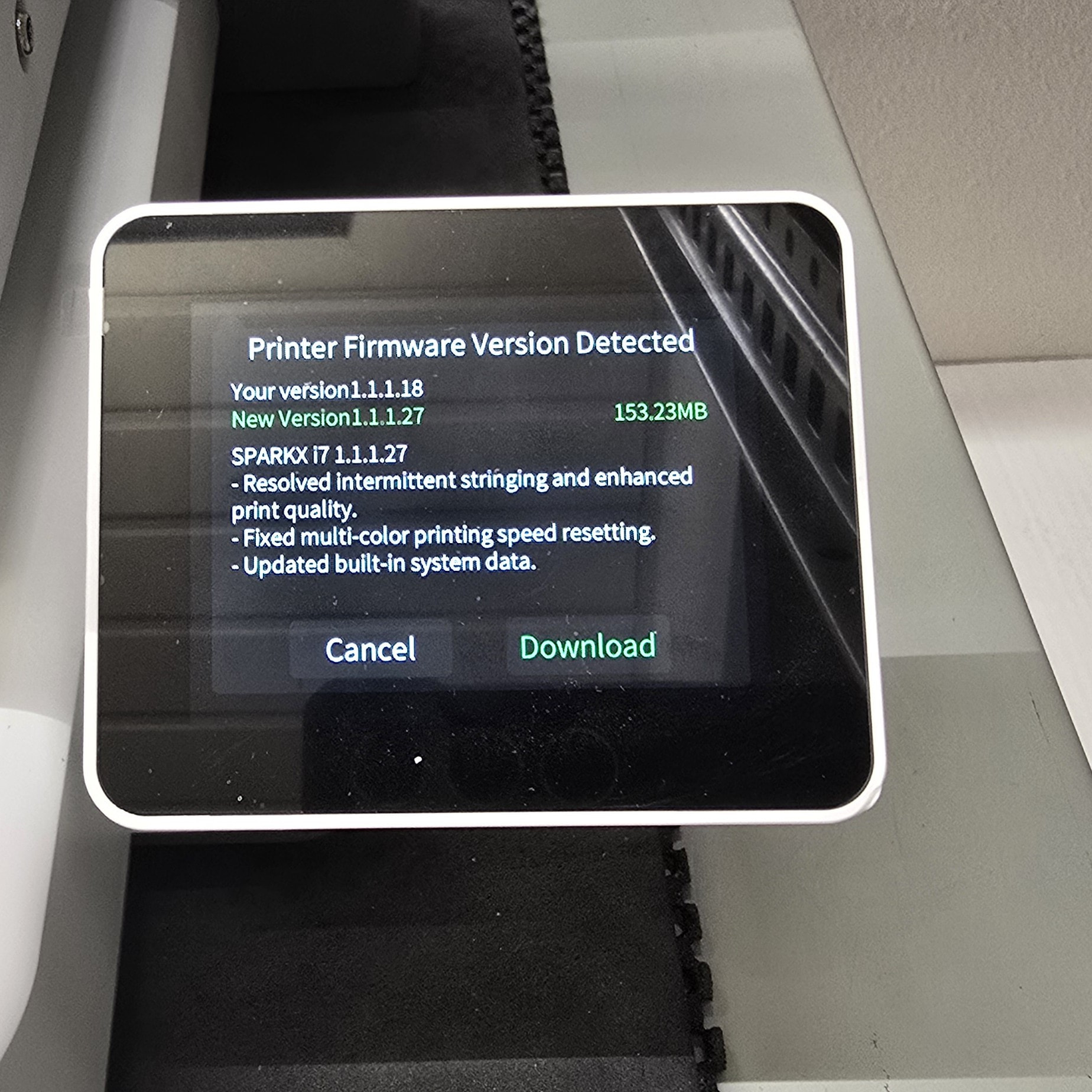

Next the printer will check to see if there is new firmware available. If download is selected, it will download the update and install it. This will take some time to complete.
After the update has been installed, you will be prompted to do a bed leveling calibration.
I recommend selecting all of the settings for calibration after any update have been installed. The calibration will take about 12 minutes to run.
After the update has completed, the Sparkx i7 is ready to start printing.
