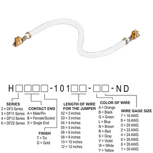

BTW, if, after looking at that crimper you are considering alternatives, we do sell contacts already attached to wires of various lengths and colors here.
These are ready to be inserted into the housings to make a functional connector-wire assembly.
