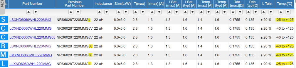

If you are looking for the difference between the TAIYO YUDEN Inductors NRS6028T220MMGJ and NRS6028T220MMGJ8, please refer to the information below:
The NRS6028T220MMGJ and NRS6028T220MMGJ8 differ primarily in their operating temperature ranges and recommended applications.
NRS6028T220MMGJ operates between -25°C and +125°C and is suitable for general equipment such as mobile devices or medical devices classified as international Class I or II.
NRS6028T220MMGJ8 supports a wider temperature range of -40°C to +125°C and is recommended for telecom infrastructure, industrial applications, or medical devices classified as international Class III.
