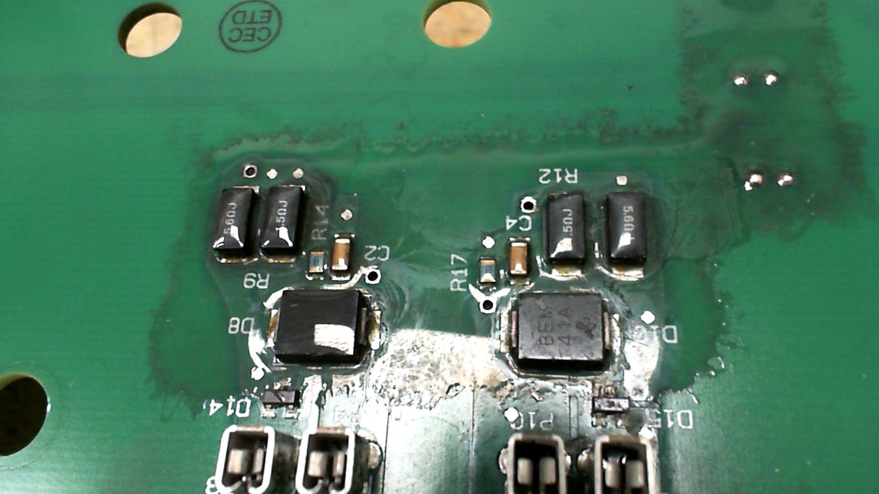

I am looking for replacement or exact match of “BEM 41A” marked diode.
Thanks
Hello @SavanPatel
Please share the image or provide more details about the part so it will be easier to find an alternative.
It appears there are a few diode manufacturers that use BEM as a part marking.
If you could kindly provide a picture of the part it may assist in identification. Sometimes they have a maker’s mark (logo) on them.
I have attached photos of part and board. It is an inverter board in Allen Brandley VFD drive.
That appears to be a Vishay General Semiconductor logo.
I provide for your consideration:
SMCJ15CA-E3/57T
