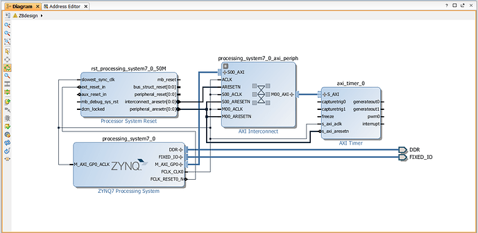

In the hardware portion of this example, a Xilinx AXI timer will be added to the PL fabric and the UART in the PS will be enabled along with other PS peripherals. These will be used for the classic “Hello World” and breathing LED demos. Of course the ZynqBerry is far overqualified for such simple tasks, but the goal is to learn about the tools and workflow for a Zynq-based project.
Block Diagram
Since hardware remains mostly the same regardless of operating system, it seems the most logical place to begin. A basic ZynqBerry hardware setup in Vivado may look something like this:
This is part of the Test Board reference design from Trenz. At first glance, this can look a little daunting since there are a lot of connections and signals. However, Vivado can automate most of the procedure.
- Start by creating a new RTL project (without specifying sources) targeting the XC7Z010CLG225-1 part.
- Next add the ZYNQ Processing System block and any other IP to be used by right-clicking and choosing Add IP… . For this example, an AXI Timer from the Xilinx catalog will be used. Vivado will then present a notification that Designer Assistance is available.
- Click on Run Block Automation , which will generate external connections for the DDR interface and the FIXED_IO ports.
- Next, click on Run Connection Automation and select All Automation from the menu. Vivado will now automatically add any IP and connections necessary to connect the chosen IP to the PS.
- If the block diagram is a bit messy, click the Regenerate Layout (
) button to the left of the diagram to organize it. The result should look something like this:
Notice that Vivado added a Processor System Reset block and an AXI Interconnect block. The System Reset is fairly self explanatory. The AXI Interconnect block takes the AXI Master (GP Port) output from the PS and creates separate AXI masters for any peripherals in the design.

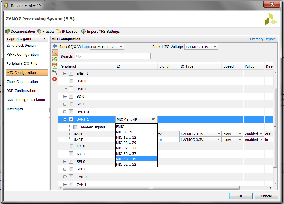

PS Configuration
In addition to the peripherals available in the PL, there are also peripherals that are part of the PS such as I2C, SPI, and UART interfaces, GPIOs, and memory interfaces.
- To configure these, double-click on the ZYNQ Processing System block.
To make things simple, use the TCL file included in the project downloads above which contains a preset for the ZynqBerry based on the Trenz reference design.
- To apply the TCL file, click Presets > Apply Configuration… then browse to the ZynqBerryPSDefault.tcl file. This file enables most of the available peripherals and assigns them to the appropriate MIO pins where applicable. Most of these aren’t used for this example, but may be useful in other applications. Notice that the USB interface is enabled instead of Ethernet since the ZynqBerry uses a USB-to-Ethernet bridge.
Take a look at the MIO Configuration page and become familiar with the available options.
IO Configuration
It is important to understand the difference between the MIO and EMIO options seen in the IO column. The MIO (Multiplexed IO) pins are a fixed set of dedicated pins that certain peripheral functions can be assigned to. These are exported as part of the FIXED_IO port that Vivado made during the Block Automation earlier. MIO’s are only connected to the PS and not to the PL.
If a peripheral is routed through EMIO (Extended Multiplexed IO), Vivado will create a special port for that peripheral on the Zynq PS block that can be assigned like any other signal in the PL. EMIOs are simply wires from the PS to the PL.
For GPIO, MIOs are numbered 0-53. EMIOs are numbered 54-117. So if GPIO is routed through the EMIO, the numbering needs to be offset by 54 when writing software. GPIO[0] would be routed to IO 54, GPIO[1] to IO 55, and so on. This can be a bit confusing when all Vivado shows is a GPIO bus numbered [63:0].

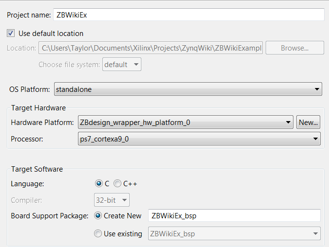

Standalone Software Design

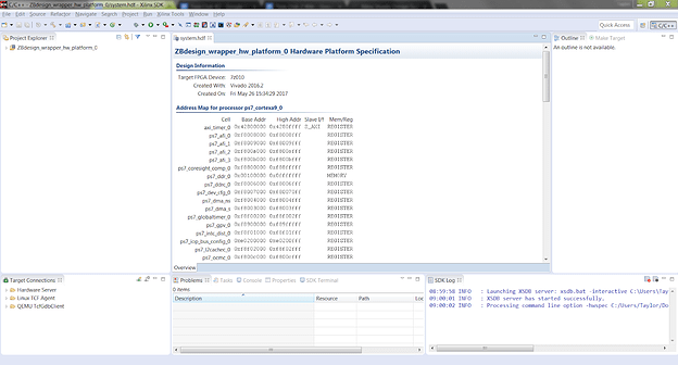

At the end of the previous step, the Xilinx SDK should have opened and imported the hardware that was just created. If it was successful, the address map for the available peripherals will be seen on the first screen. This section will provide a brief guide on setting up a bare-metal C project for the Zynq.
Go to File > New > Application Project . Set up the project with the settings below noting that the OS platform is set to standalone .
Click Next and confirm that the Hello World template is selected. Click Finis h to create the project.

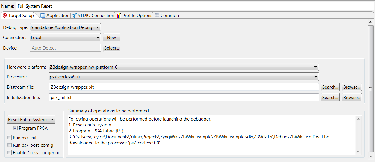

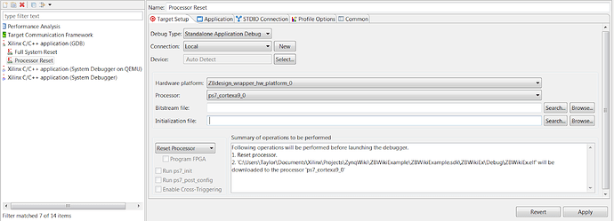

Run Configuration
Before writing any application code, it is useful to set up run configurations for the project.
From the menu bar select Run > Run Configurations . In the left panel right-click Xilinx C/C++ application (GDB) and choose New . I set up two separate configurations, one for resetting the processor and loading new C code and one that does a full system reset and also reprograms the FPGA.
For the processor reset, go to the Application tab and select Browse … next to Project Name . Verify it is the name of the project that was just created. Select it and it will populate the Application field with that project’s .elf file.
- Go back to the Target Setup tab and make sure that Reset Processor is selected in the dropdown menu at the bottom.
- (Optional) Follow the same steps to create a full system reset configuration, but modify the following items on the Target Setup tab:
- Select Search… next to the Bitstream file field. It should automatically find the bitstream generated in Vivado. Double-click it to populate the field.
- (Optional) Repeat step 1 to populate the Initialization file field with ps7_init.tcl.
- Select Reset Entire System from the dropdown and check the Program FPGA box.

Xilinx’s API documentation and examples can be quickly accessed from the system.mss file that opens when a project is created. Most of the AXI peripherals that can be used follow a very similar API.

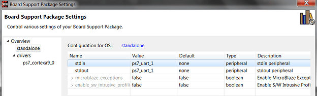

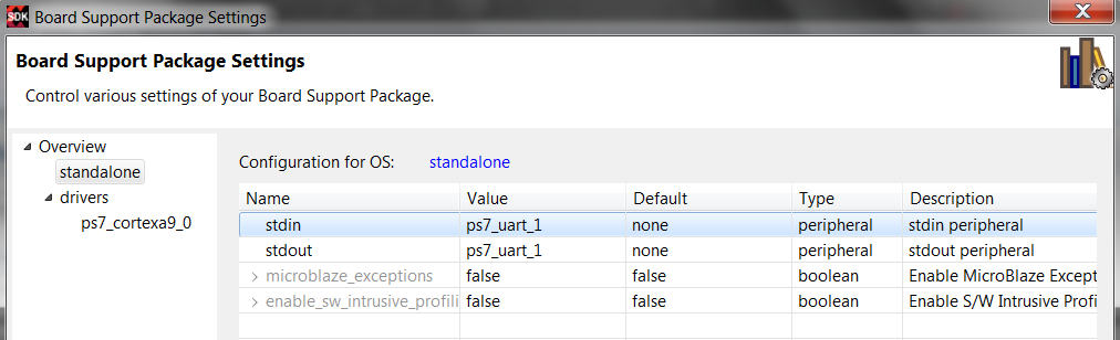

Modifying BSP Settings
Stdin and stdout will default to UART 0 if both of the UARTs are enabled. Since UART 0 is not connected to the USB to Serial adapter, this setting needs to be changed to UART 1.

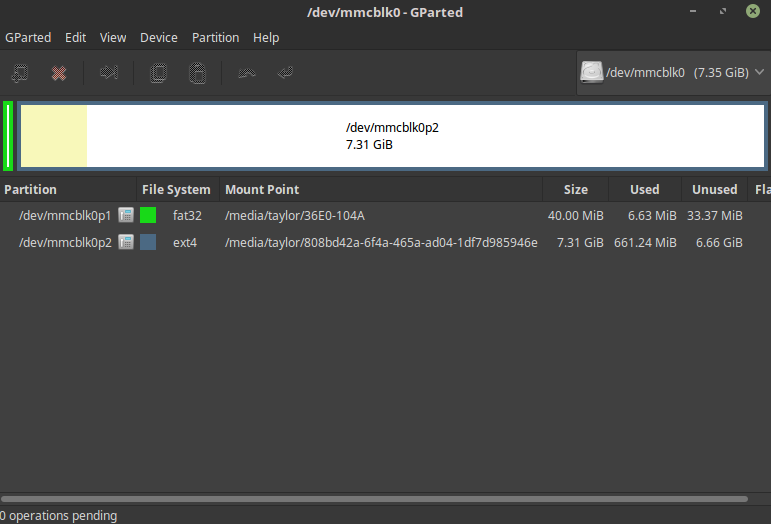

Prepare SD Card
- Format an SD card with two partitions: one FAT32 for the boot section and one EXT4 for the root filesystem. Use a method of your choice like parted, dd, etc. Assuming the SD card is /dev/mmcblk0.
sudo parted /dev/mmcblk0
# Check existing partitions
print
# Remove any existing partitions if any
rm 1
rm 2
# Create a boot partition, optimally aligned
-a optimal mkpart primary fat32 0 40MiB
# Create the rootfs partition with the rest of the card
-a optimal mkpart primary ext4 40MiB 100%
# Disable lba flag on partition 2
set 2 lba off
# Check new partitions
print
# Result should look something like this:
#Number Start End Size Type File system Flags
# 1 1049kB 39.8MB 38.8MB primary fat32 lba
# 2 41.9MB 7901MB 7859MB primary ext4
