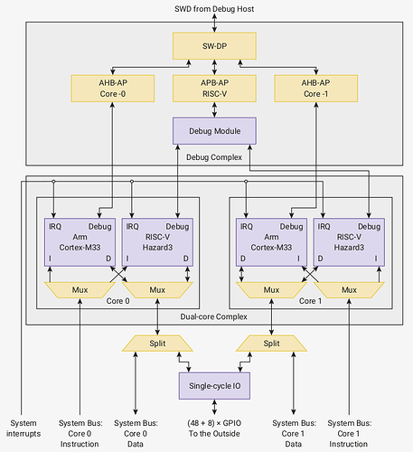

The synchronization demo has 2 threads that use semaphores and sleeping to take turns to print a message via USB at a controlled rate.
The Raspberry Pico 2 is a dual-core, dual-architecture capability of RP2350 allows users to choose between a pair of industry-standard Arm Cortex-M33 cores, and a pair of open- hardware Hazard3 RISC-V cores.
This is a good alternative to start learning about Zephyr OS (Devicetree, KConfig, CMake, Ninja, GCC) for those who can’t wait 2 more weeks for the release of the Arduino Uno which includes a Qualcomm® Dragonwing™ QRB2210 is a quad-core Arm® Cortex®-A53 running Debian Linux OS and also TMicroelectronics® STM32U585 is an Arm® Cortex®-M33 running Arduino Core on Zephyr OS.
