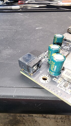

Help identifying DC input for Infinity Arcade Table
Need help identifying a DC connector for an Infinity Arcade 1Up Table. 12V 5 Amp. Thanks in advance.
From what I’m seeing online it appears the size of this barrel connector would be 2.1mm inner diameter and 5.5mm outer diameter.
Based on that and visual identification here is what I’m finding:
RAPC722S by Switchcraft Inc.
Thank you! We’ll get ahold of that part.
