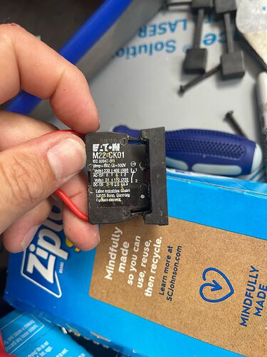

Hello, i am new to this forum but i hope you guys can help me to find the replacement for this push button switches from eaton.

here are the pictures
more pictures
Based on the marking M22-CK01 is a SPST-NC contact block 5730-M22-CK01-ND that is compatible with a switch 5730-M22-D-G-K01-ND which is a normally off momentary on function.
The second looks to be a contact block M22-CK10 5730-M22-CK10-ND which is the opposite SPST-NO. The compatible switch for that 5730-M22-D-R-K10-ND is the normally on momentary off function.
That contact blocks are compatible with a few other switches from M22, and M22M series so please review the offered ones to verify if they will work for you.

As a side note, the red tab typically identifies the switch block as normally closed while the green tab indicates normally open.
Please let us know if you have any troubles locating a replacement as the 22 mm switch types are wonderfully complex when we consider the number of unique configurations.
