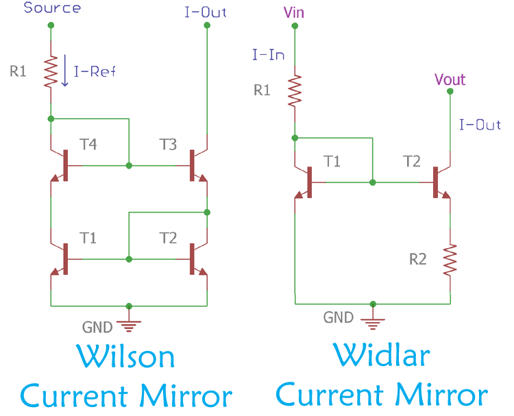

I learned that there are current mirrors - Wilson Current Mirror and others, will try making them.

If it’s of any help here is Analog Devices Electronics I and II Chapter 11 on Current Mirrors
Chapter 11: The Current Mirror [Analog Devices Wiki]
This is the link where I got the picture above, there’s a more detailed description.
