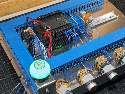

What matters when selecting a PLC?
Since this is one of your first projects there are a few rules of thumb:
Stay Within the PLC Family
  • Look around the shop and select a PLC from the same family. This allows you to leverage the local knowledge base. Chances are high that DigiKey offers a PLC from the same family.
Determine the Required Number of Inputs and Outputs (I/O)
  • Inventory the machine to determine:
    • Number of sensors
    • Number and type of actuators, such as motor starters, pneumatic solenoids, and panel lamps.
Provide a Safety Margin
Since this is your first project, accept the fact that you will make mistakes. Therefore, it is prudent to err on the side of too much. For example, you don’t want to be short in your I/O calculations, as an error would require a new PLC or possibly an expansion module. As a safety margin, multiply your initial I/O estimates by 25%.
Safety
Let me leave you with one final, but often overlooked, consideration. The general-purpose PLC is not safety rated and should never be trusted to shut down a machine.
For example, wiring an emergency stop into a general-purpose PLC is unacceptable. Instead, the emergency stop should be wired into a failsafe device rated for the hazard level of your machine. Click here for an introduction.
