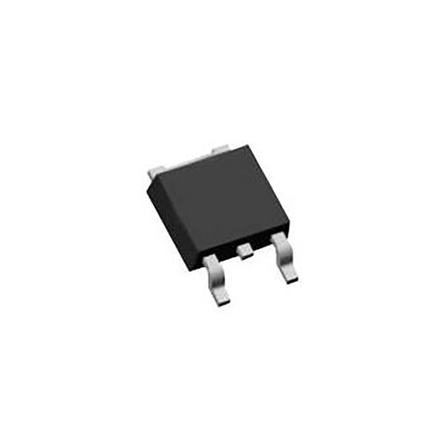

I need to find this transistor. The marking on it is 2510 3K02. This is a power supply to a compute
That part might be H5N2510DL from Renesas. Here is the datasheet https://www.renesas.com/en/document/dst/h5n2510dl-h5n2510ds-datasheet?r=1339571. They don’t list the part marking info, so I was unable to make sure its correct. However, based on their part marking guide https://www.renesas.com/en/document/tcu/pcn-marking-power-transistors, the 2501 should call out that part.
This is the reading from a other one that is on the pcb. Is this the correct part H5N2510DS ? And if so do you have it ? I see you got the H5N2510DSTL-E on the DigiKey browser

I’m glad you provided that test as it put one of my questions to rest. I was concerned we were dealing with a linear regulator, but that is not the case.
At this point we need to find a suitable replacement available in single quantities. May I recommend you consider these candidates:
Be sure to verify the datasheet electrical and mechanical specifications.

These are the ratings on the backside of the computer
Thank you @Blurry82,
Unfortunately, I am unable to cross a power supply to a given PC.
How I wish schematics were freely available.
