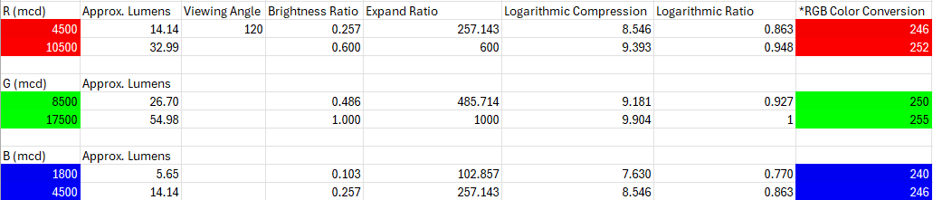

Method Two Results
I also wanted to generate visuals only using the data available in the datasheet. The previous method uses an external maximum luminosity value. This method uses a relative ratio comparing to the maximum brightness value in the datasheet. This ratio lets you establish a basis for using a natural logarithm.
I did have to take the base ratio and multiply it by 1000 to make it large enough for a logarithmic scale. I just wanted to have a good approximation of how the human eye perceives light. I used the formula below to convert that to a log scale.
CodeCogsEqn
In order to convert that into an applicable RGB range of 0-255, the value must be between 0 and 1. I used the maximum brightness logarithmic value as the base line to convert it back. I found that a minimum RGB value of 190 is the closest intensity to 5 lumens based on method one. The conversion formula is 190 + (255-190) * Ratio. As you can tell, both methods have colors that look virtually identical in bright light. They will be more distinguishable in a dark setting; however, they are still going to be very difficult to tell apart between one LED and another. This is showing the worst-case scenario where the values are as far apart as they appear in the datasheet.
