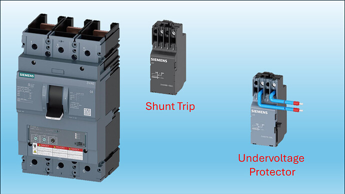

Note that Figure 1 showcases one of the smallest shunt trip combinations available. At the other end of the spectrum are large three-phase devices such as the 400A Siemens 3VA63405HL310AA0 as shown in Figure 2. The 120 VAC 3VA99780BA22 shunt trip module is also shown in the image.

Figure 2: Large Siemens circuit breaker shown alongside the shunt trip and undervoltage protector modules.

Tech Tip: The failsafe-trip-upon-loss of control voltage option is available for many of the larger circuit breakers. For example, the previously mentioned Siemens breaker may be optionally equipped with the 3VA99780BB24 undervoltage protector.

In this situation an undervoltage protector may have been a better option than the shunt trip as it would ensure the breaker trips upon loss of power.
