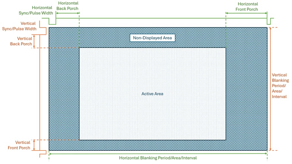

Display Timing Parameters Diagram
Display Parameters Relationships
Vertical Blanking Period = Vertical Sync Width + Vertical Back Porch + Vertical Front Porch
Horizontal Blanking Period = Horizontal Sync Width + Horizontal Back Porch + Horizontal Front Porch
Vertical Total Size = Vertical Blanking Period + Active Area Height
Horizontal Total Size = Horizontal Blanking Period + Active Area Width
Horizontal Scan Rate = Vertical Total Size × Vertical Frame Rate
Line Frequency = Frame Rate x Vertical Total Size
Pixel Clock = Line Frequency x Horizontal Total Size
= Frame Rate x Vertical Total Size x Horizontal Total Size

Active Area
Active area is the visible part of the display (what the user can see).
Blanking Period
Blanking Period is the phase between each line (horizontal blanking) and each frame (vertical blanking). This was originally intended to give CRT monitors the chance to move the electron guns. However, LCD displays don’t need as much time, so the blanking area can be reduced.
Horizontal Front Porch (HFP)
Numbers of pixel clock pulses (pixels) between the last valid pixel data (end of Active Area) in the line and the next Horizontal Sync pulse. It is also known as sync offset, is basically the number of pixel clock before the sync pulse
Horizontal Back Porch (HBP)
Numbers of pixel clock pulses (pixels) between the Horizontal Sync signal and the first valid pixel data in the line (Active Area). It can also be known as the number of pixel clocks after the sync pulse, before the start of the active pixels.
Sometimes this can also be referred to as Horizontal Sync Pulse. Number of pixel clock pulses when a Horizontal Sync signal is active. It is the duration of the horizontal sync pulse. The sync pulse marks the start of the next line or the start of a new line of video data.
Horizontal Sync Polarity
Value of Horizontal Sync to indicate the start of a new line (active LOW or HIGH).
Vertical Front Porch (VFP)
Number of lines (Horizontal Sync Pulses) between the last valid line of the frame (end of Active Area) and the next Vertical Sync Pulse. It is also known as sync offset, is basically the number of lines before the Vertical Sync Pulse.
Vertical Back Porch (VBP)
Number of lines (Horizontal Sync Pulses) from a Vertical Sync signal to the first valid line (first line of Active Area). It is also known the number of lines after the sync pulse, before the start of the active lines.
Vertical Sync Width
Sometimes this is referred to as Vertical Sync Pulse. Number of H-SYNC pulses when a VSYNC signal is active. It is the duration of the vertical sync pulse. The sync pulse marks the start of the next frame.
Vertical Sync Polarity
Value of Vertical-Sync to indicate the start of a new frame (active LOW or HIGH).
Active frame width
Horizontal resolution of the display.
Active frame height
Vertical resolution of the display.
Screen Width
Number of Pixel clocks between the last Horizontal Sync and the new Horizontal Sync.
Screen height
Number of lines between Vertical Sync Pulses.
