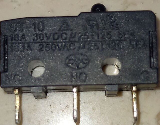

How can I find this switch or a similar one?
Greetings,
I’d approach the task by looking up the limit switch family and applying filters based on observable criteria. One can see that it’s an SPDT switch for example, that it doesn’t have wire leads, current ratings in 10A territory (though that may not all be needed, depending on the application) and so forth.
One the result set has been pared down nicely to exclude known non-matches, I’d then sort by price and start checking datasheets for options that look promising for dimensional compatibility. This is the point where I’d start that process.
Do you know what 30vDC means? and how to find
Hello @MrK
The switch is marked with the Maximum current ratings and the Maximum voltage ratings for AC (alternating current) and DC (direct current). The limit switch category can be filtered by AC and DC voltage ratings.
Is it possible to find an exact match or a similar one to buy for replacement?
I’ve been unable to find specifications on your original switch doing searches for ST-10 Limit Switch online.
It would be advisable for you to go through the list of switches Rick provided to see if anything comes close dimensionally.
