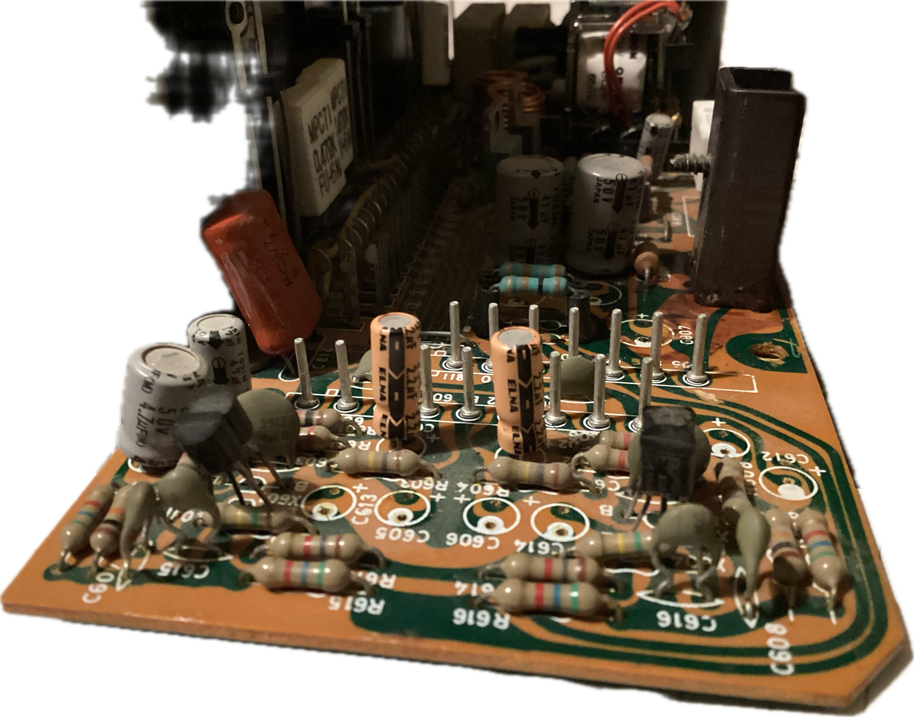

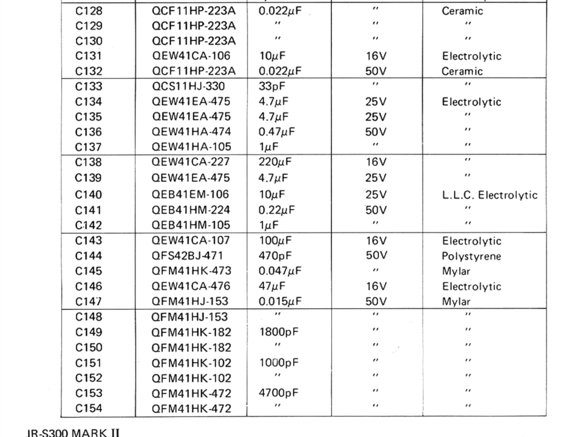

I have a number of LLC capacitors as in the photos that I need alternatives for please(the orange ones). Listed as C140, C141 and C142. What should I be looking for?
David
@djhando
Would you have dimensions for the items you are needing?
Diameter -
Height of the body -
center to center lead spacing -
Yeah most are 5.2mm dia x 13.5mm high with lead spacing of 2.5 but spacing on board is 5mm. The 10uf is 6.5mm dia. I require 6 different values from 0.22uf 50v, 0.47uf 50v, 1uf 50v, 2.2uf 25v, 4.7uf 25v and 10uf 25v.

And what is the difference in a LLC capacitor?
Cheers
And I’m relying on you here as I don’t know what a LLC capacitor is. It’s for a 40+ year old jvc stereo receiver.
Thanks, David
Hello @djhando
the LLC stands for low leakage current, and I check on the 0.22uf 50V capacitors but we would not have any LLC capacitors in stock and an example of that capacitor that I found is part number UKL1HR22KDDANATA
