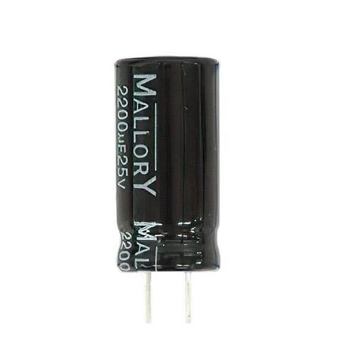

Good day I’ve got another one it’s three capacitors but they are made of what appears to be a light cardboard…from a 1970 sears and robock stereo radio counsel the markings are different
#1 says malloy 2000MFD 25VDC RED
#2&#3 1000 MFD 25 VNP BLK. As you can see at bottom got chew up when I took them out …
take a look at these options.
565-EKYC250ELL202MK20S-ND 2000UF 20% 25V RADIAL
1189-1245-ND 1000UF 20% 25V
Wow, I’d forgotten that cardboard insulation was still on some back then, the change to plastic wrapping was underway.
It turns out one of the marketplace suppliers has Mallory parts in stock that should work for this.
However to get them faster and save some cash, I’d buy the excellent subs @Robert_1552 suggested.

So im working on a 1970 sears robock stereo console. I ordered parts and electrolytic capacitors from DigiKey and everything arrived perfect and timely except for me and my oversight or lack of.. i have 3 capacitors they are 3 inches tall x 1 inch round ..1 capacitor 2000 mfd x 25v is labeled black is negative. With a red and black wire coming out of it..the other 2 capacitors 1000mfd x 25v both have red wires coming out of it ..wich im assuming is positive..i dont know how i should hook up new capacitors or if i even got the right ones ..the new capacitors are 1000uf 20 % 25v
The old capacitors appear to be made of wrapped in cardboard
Hello jessegrob94,
This is sort of a tough one because MFD can mean both millifarads or microfarads. (Click HERE for a Forum post regarding this dilemma.) I believe due to the age of capacitor it is most likely going to be in microfarads; or what we commonly have as µF. This means the 1000µF capacitors should work for the two 1000mfd capacitors. You will want a 2000µF part for the 2000mfd capacitor HERE. (Note that it may say 2mF or 2000uF. These are the same values.) My concern, however, is that you mention 3 terminals on the larger value capacitor, and most of these will only contain two. I did a little research and Murata has a nice explanation regarding how they can help as a filter. I mention this as I’m not sure how important that is for your application, and the capacitors in the link I provided do not have that third terminal.
In regard to hooking them up, it may be extremely important to know the polarity of the circuit as if they are not connected in the right polarity, you can expect some loud popping sounds in your future. Check out our guide referring to identifying the capacitor polarization indicators to ensure that can be confident you’re hooking them up correctly.
