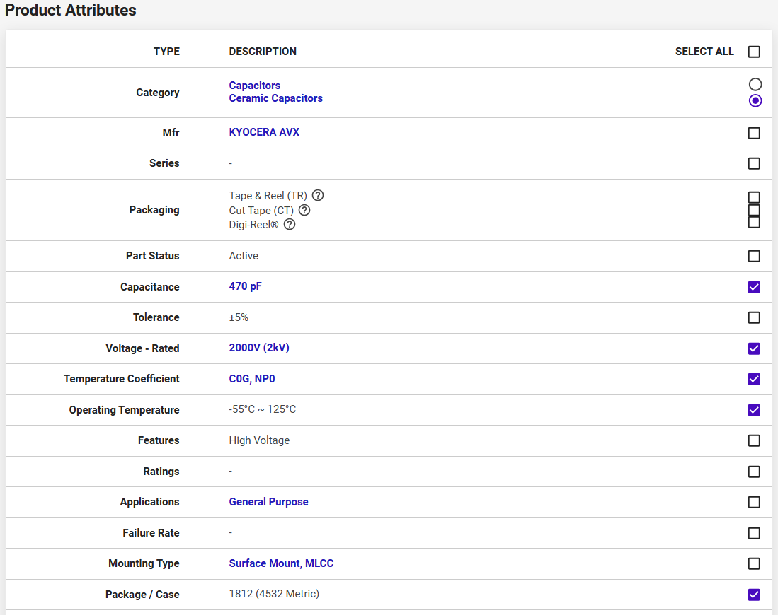

Could you please provide an alternative part for 1812GA471JAT1A with at least 3200 pieces in stock?

I found the 399-C1812C471JZGACTUCT-ND.

Hello @malavb,
Let’s perform a reverse lookup:
Start on the product page.
Select the product attributes that are important to your application as shown in this image. For this example, I chose 470 pF, 2 kV, NPO, and 1812.
Select “View Similar”.
Determine if the remaining capacitors meet your needs.
Revise specification if necessary. For example, would a 510 pF capacitor meet your needs.
Sincerely,
Aaron
Given your immediate needs, consider CHV1812N2K0471JCT Cal-Chip Electronics, Inc. | Capacitors | DigiKey Marketplace. The specifications are close and the requested quantity is available.
