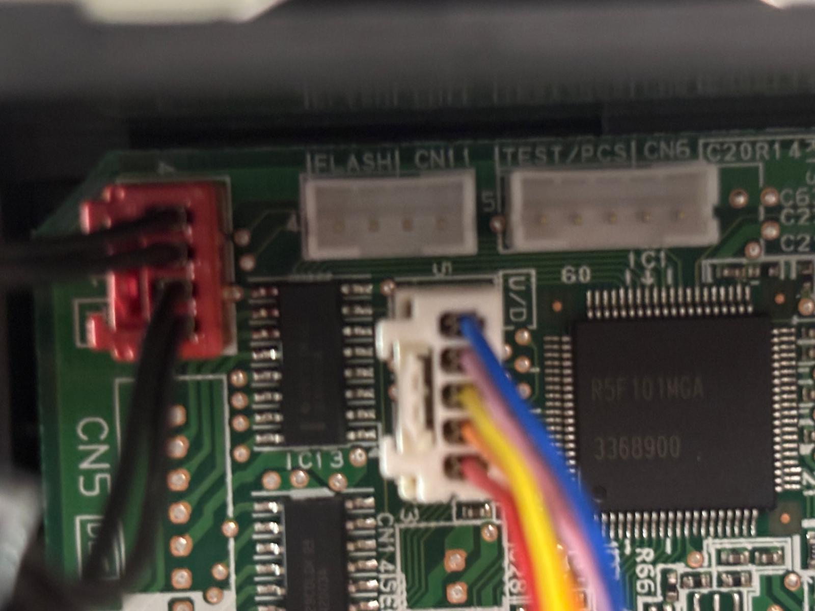

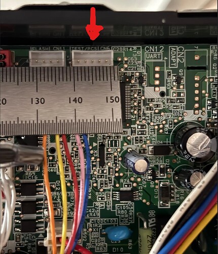

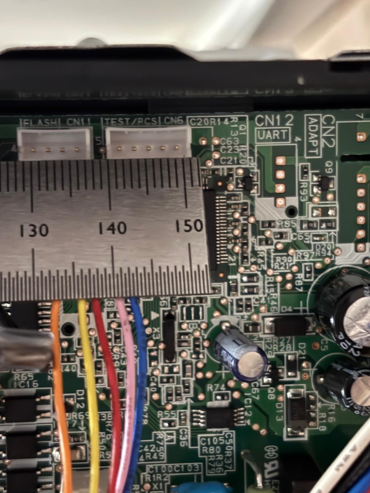

Hi,
I have this connection on a Fujitsu air conditioner PCB. I need a connector to fit this CN6 socket. Would you know what this connector is called? It has 5 pins, and looks like 2mm apart.
Is there a pre-made cable for this available?
Thanks

Hello Justme555,
To find a mate, I first looked for the connector on your board.
A possible match is 455-1707-ND. The mating connector is 455-1163-ND.
We do not have a pre-made cable, but we do have pre-crimped leads that you can install.
Click here for the pre-crimped lead options. Depending on how long of a lead you want, you can cut a 12” lead in half, to make two 6” leads, or just cut one end off for about a 12” lead.
Please check the datasheet to verify compatibility to your application.
