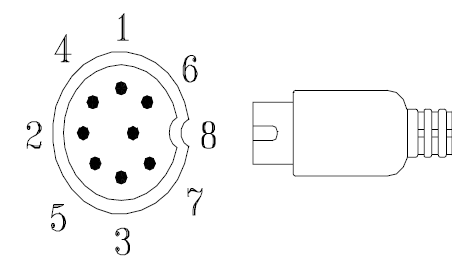

I am urgently looking for a discontinued power supply (or alike) “PUP130-14” with an 8 pin circular (270°) Din output plug (max. 130W, 24Vdc, 5.4A). The specifications are very well documented here: https://trumpower.com/acdc/pup130.html (including the data sheet with a picture).

Welcome to the DigiKey TechForum. I searched and wasn’t able to find an option to offer for this. The issue was trying to match the pinout of the 8 position din connector.
Hey Steve, thanks for your reply and effort. That was a problem for me, too. I might found a solution with the distributor of the device that is to be powered and keep you updated.

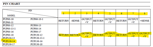

I was thinking the MWA180024A-12A would do the job, but it looks like the pin-out of the DIN connector is exactly opposite. Strange.
Pin-out for MWA180024A-12A:
Pin-out for PUP130-14:
