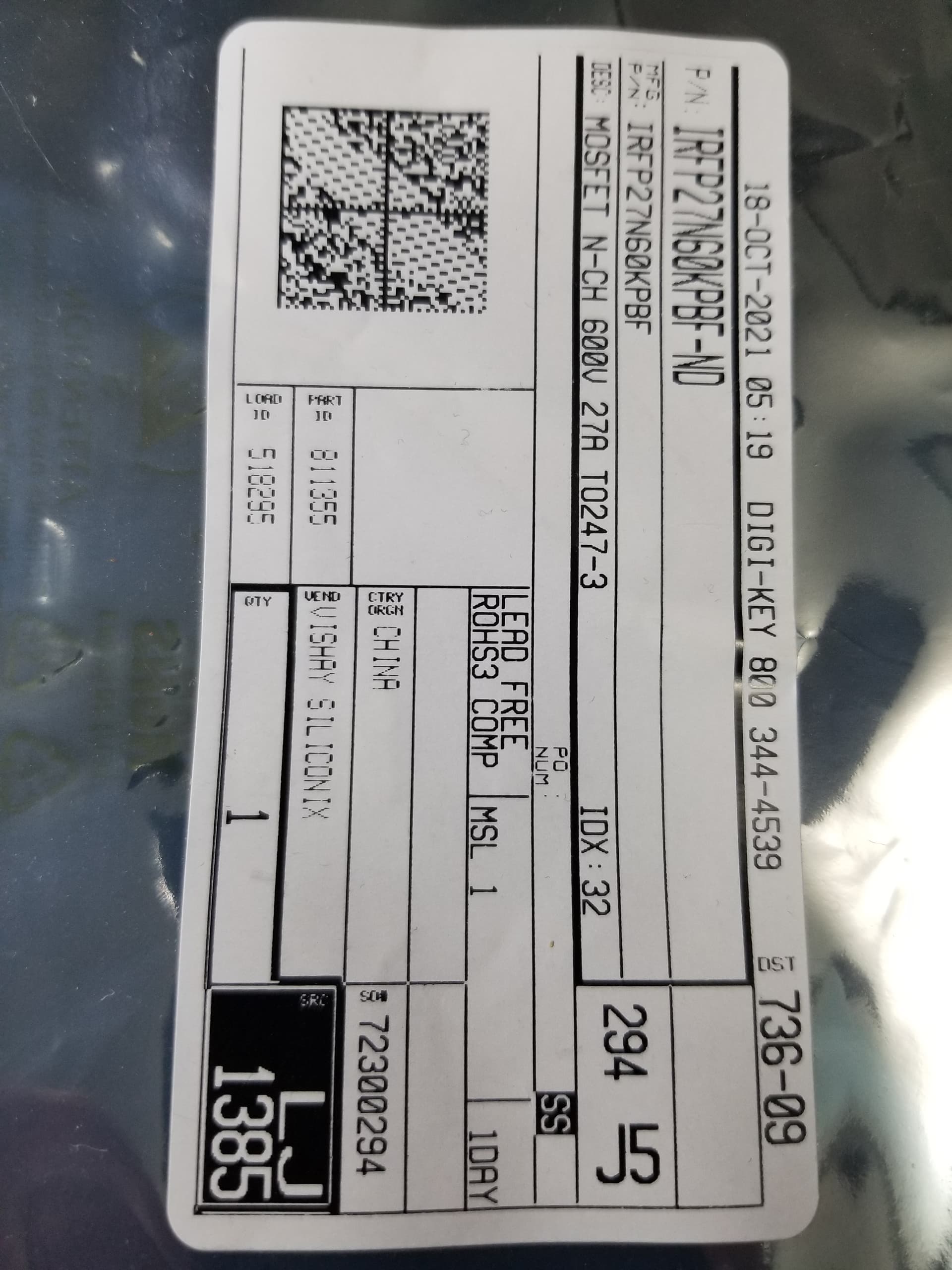

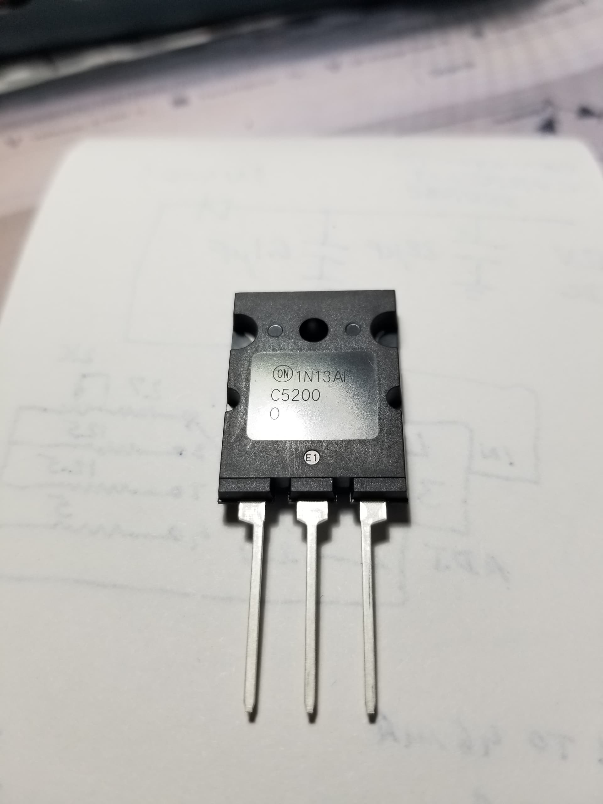

DigiKey bag shows “IRFP27N60KPBF-ND”, component inside shows " 1N13AF C5200 ". Is this the component I ordered?

Here are the photos
Based on the given marking, you got one of the below.
C5200 from On Semi
I would say you did not get the Vishay item.
