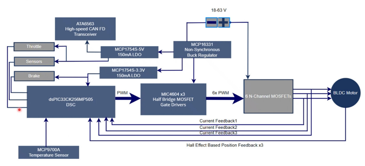

Motor Control System Block Diagram for Electric Bicycles (e-Bike)
Core Logic of the System (Block Diagram + Application Scenarios)
Functional Objectives
To achieve precise motor control of electric bicycles, covering modes such as manual, electric, and pedal-assisted. It supports efficient driving (FOC algorithm), short-term acceleration (field weakening technology), and energy recovery (regenerative braking), and is adaptable to complex scenarios such as urban commuting and hill climbing. In addition, it is equipped with on-board Flash for driving data recording.
Signal Flow (From Command to Motor Drive)
- Input Commands: Inputs from Throttle (accelerator/speed adjustment), Brake (braking), and Sensors (e.g., temperature sensor MCP9700A, Hall current sensor, and position sensors required for sensor-based FOC, which support Hall, magnetic encoder, inductive, resolver, etc.) are processed by the dsPIC33CK256MP505 DSC (Digital Signal Controller).
- Control Calculation: The DSC runs algorithms such as FOC and outputs PWM signals to the MIC4604 half-bridge gate drivers, which then drive the 6 MOSFETs to ultimately control the brushless DC (BLDC) motor.
- Power Supply and Communication: The MCP16331 Buck Regulator converts the 18-63V input to low voltage, and the MCP1754S LDO outputs 5V/3.3V to power the control circuit; the ATA6563 CAN FD transceiver enables high-speed communication (e.g., driving data, fault feedback).
