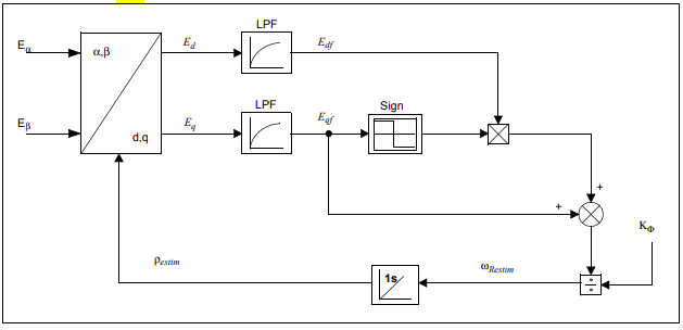

Anti-Interference Performance and Accuracy of PLL (Phase-Locked Loop) for Multi-Level Speed Sampling
The block diagram of a PLL (Phase-Locked Loop) typically includes three core modules: Phase Detector (PD), Loop Filter (LF), and Voltage-Controlled Oscillator (VCO). In some scenarios, a frequency divider or signal preprocessing unit may be added. Its core logic is to achieve accurate synchronization between the “input signal frequency/phase” and “output signal frequency/phase” through closed-loop feedback.
Image source: Microchip
Functions of PLL Modules
- Phase Detector (PD): Compares the estimated rotor position with the phase of the observed voltage signal.
- Loop Filter (LF): Acts as a low-pass filter to eliminate high-frequency noise.
- Voltage-Controlled Oscillator (VCO) or Integrator: Adjusts the speed and position estimation based on the filtered output.
The core logic of the PLL (Phase-Locked Loop) is to achieve accurate synchronization between the “input signal frequency/phase” and “output signal frequency/phase” through closed-loop feedback.
