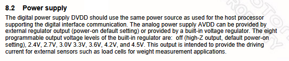

I believe AVDD and AVSS are output voltages based on this paragraph and the use of the phrase provided by a built-in voltage regulator.
1.8 Power Supply
The digital power supply DVDD should use the same power source as used for the host processor supporting the digital interface communication. (check - I’m using 3.3V from the BeagleBone for the DVDD). The analog power supply AVDD can be provided by external regulator output (power-on default setting) or provided by a built-in voltage regulator. The eight programmable output voltage levels of the built-in regulator are: off (High-Z output, default power-on setting), 2.4V, 2.7V, 3.0V 3.3V, 3.6V, 4.2V, and 4.5V. This output is intended to provide the driving current for external sensors such as load cells for weight measurement applications.

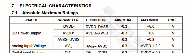

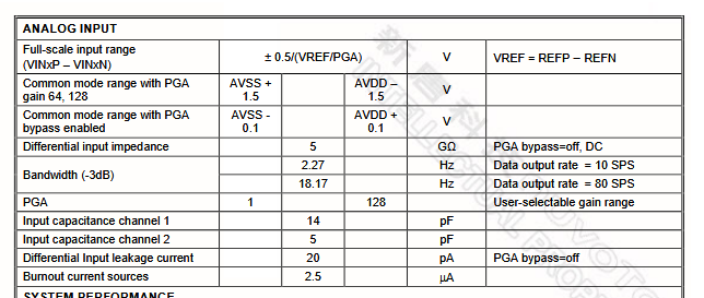

Regarding excitations and inputs to the device, one should look to the relevant Analog Input specifications:
The abs max figures tell you that the the potential applied to any analog input needs to stay between the supply rails for the part, while the Common Mode figures further tell you that the average of a differential pair can’t get closer than 100mV to either supply rail if not using the built-in PGA, or closer than 1.5V to either supply rail if it is being used. Analog needs a bit of headroom to do it’s thing, and limitations of this pattern are approximately 74% as common as dirt.
You can excite your load cell with whatever potential you choose (within its stated limits) so long as the resulting output complies with the input limitations of the ADC. Assuming the load cell output is biased to mid-span, excitation with -2.5/+7.5 relative to ADC ground would put the common-mode input at 2.5v, right about where one might want it if running the ADC on a 5V supply. One would need to shift that down a bit for 3.3v supply and be careful about it if planning to use the PGA, due to only having 300mV worth of usable range in that case after deducting the 1.5v of headroom required on either side in that case.

The data sheets are still confusing in places. Take 7.1. Analog Input Voltage AVin has a maximum of AVDD+0.3. AVDD can programmatically be set to off (high-Z output, default power-on setting), 2.4V, 2.7V, 3.0V 3.3V, 3.6V, 4.2V, and 4.5V. So, if my input is going to swing to 0 to 350mv, it seems like I would need to program AVDD to at least 2.4V else I exceed the maximum since off appears to be high-Z. Since I’m not going to use AVDD to power my load cell, it seems weird to have to do anything with AVDD at all. So do I understand this correctly?
Looking at the example circuit in 9.4 (the Version 1.7 data sheet), RefP is connected to the excitation leg to the load cell AND AVDD. But, what if I’m exciting the load cell externally with 12VDC (within it’s parameters)? It would seem that connecting RefP to 12VDC exceeds all max voltages of the NAU7802. And if the AVDD is set to off/high-Z and RefP is connected to it instead of the excitation voltage, what does that accomplish?

Something to understand is that regardless of whether or not it’s explicitly mentioned, the majority of IC pins have a diode structure connecting to their supply rails. If an externally-applied voltage is sufficient to forward-bias this diode, a sufficient current can flow to destroy the diode and by extension the device. This is why it is so incredibly common to see abs max input figures limiting input voltages to less than a diode drop beyond the supply rails.
It’s needful to be specific about whether one’s talking of a common-mode or differential input when dealing with differential devices; the criteria in the spec table for each both need to be met.
This device is somewhat novel, insofar as it has an internal, programmable voltage regulator that can be used to generate the necessary AVDD potential. The default “high-Z” configuration means that the internal regulator is disconnected, and therefore not going to fight against an externally-provided supply.
Regardless of how or where the AVDD potential comes from or is derived, the Abs Max limitations must be respected to avoid damaging the device, and the limits in the characteristics table must be observed in order for the device to operate properly. In brief, that means A) neither pin individually should exceed the supply rails on either side, and B) the average of the two can’t get closer to either supply rail than 1.5V or 0.1V depending on whether you are or aren’t planning to use the internal PGA, respectively.

One uses the (default) off/high-Z configuration for the internal AVDD regulator when one desires to drive that pin externally. If the analog portion of the chip is not powered from an external source, and also not powered via the internal regulator, then it is not powered at all and one can have no expectation that the chip will do anything useful whatsoever. Doubly so if the the reference voltage that the chip’s supposed to be comparing the inputs to is connected to that same undefined source.
If one does supply an external AVDD in that circumstance however, then so long as the supplied potential is within stated limits, the chip will operate happily, delivering digital outputs scaled relative to (VrefP-VrefN) and the range of tolerable inputs also scaling accordingly, per criteria A and B above.
I’ll be terse: don’t connect any source of power to AVDD - but add a cap as advised. Connect AVDD to the ADC reference REFP. Also, connect AVDD to your load cell excitation source. Use firmware over I2C to set the AVDD voltage level. Connect AVSS to DVSS to REFN.

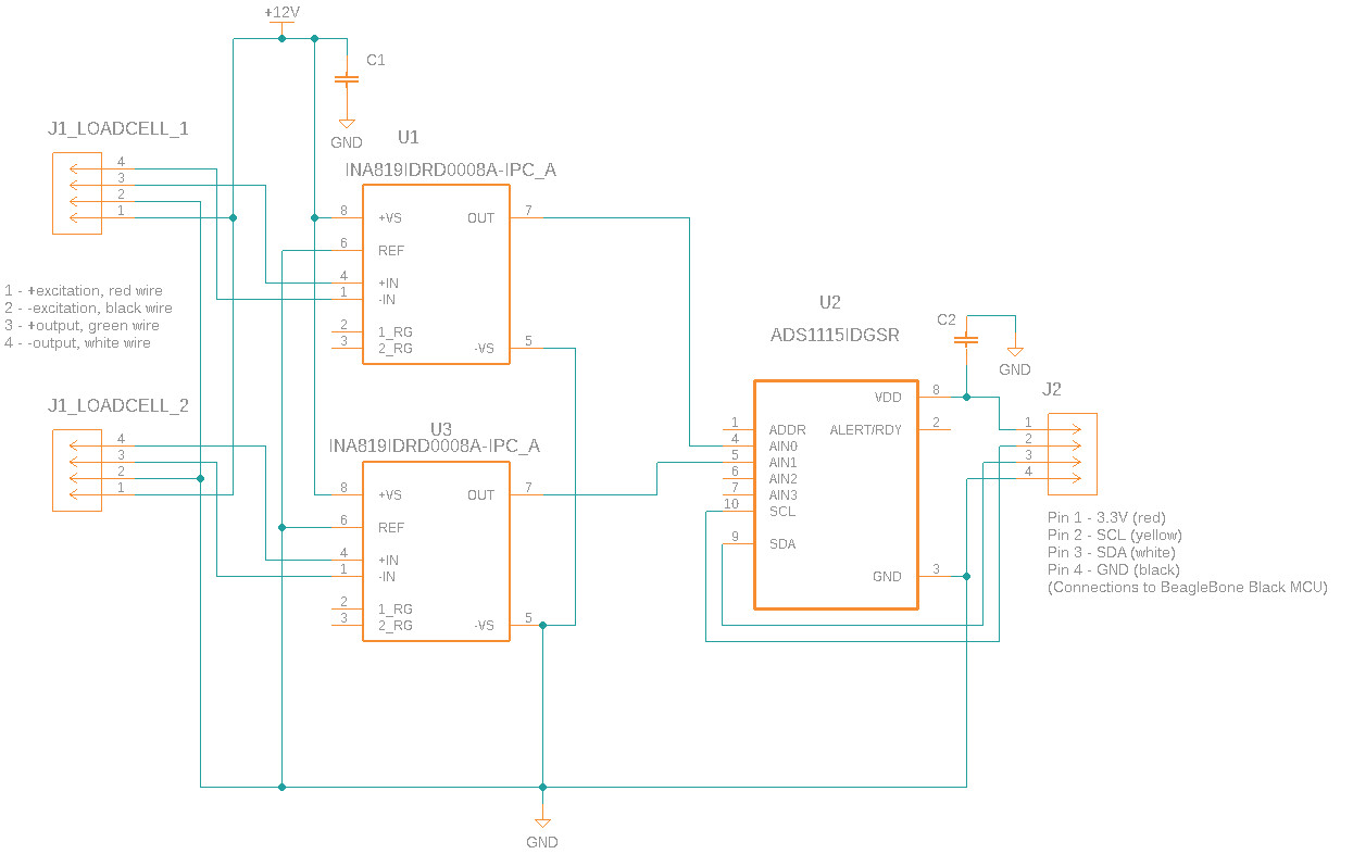

@passedpawn I appreciate your input on this. I’ve decided to ditch the NAU7802 for this. Despite thousands being used apparently, Nuvoton has terrible support and documentation.
I’m going in the direction of an instrumentation amplifier from TI, followed by a simple single-ended op amp with an I2C interface.
Right now I’m planning to use the TI IN819 or IN818 followed by the TI ADS1115 op amp. I haven’t worked out exactly the gains I will use in each stage to get what I need. The IN818 meets my CMMR requirements and the maximum input offset and drift fit too. This is a prototype, so we hand-solder and have been able to handle the SOIC packages fine, usually. It can be tricky, but we do it.
All that said, are you contradicting yourself or am I reading it wrong? You said first “don’t connect any source of power to AVDD” then later “connect AVDD to your load cell excitation source.” I assume you meant to say use AVDD as the load cell excitation source. Our load cell doesn’t perform well at the excitation voltages the NAU7802 can supply to AVDD which is another reason I will ditch it. The TI in-amps can be powered up to 36V which allows us to power the chip and excite the in-amp from at 12VDC from the same rail. At least that’s how the literature from TI presents it. I’m working with TI on it too. They have outstanding support.

@passedpawn I’ll do that. TI design support reviewed the design I posted and noted that I need to input 200mV to REF to accommodate the minimum output requirement. Otherwise it should work fine.
I appreciate your circuit and suggestion. We don’t currently use SPI, although the BeagleBone has the capability under the Linux version we’re using. But it would require exchanging one of the I2C busses for SPI, and we’d have to redesign some other stuff to move it over to the other I2C bus. so, all that said, its better for us to stick with I2C unless this just doesn’t work at all.
