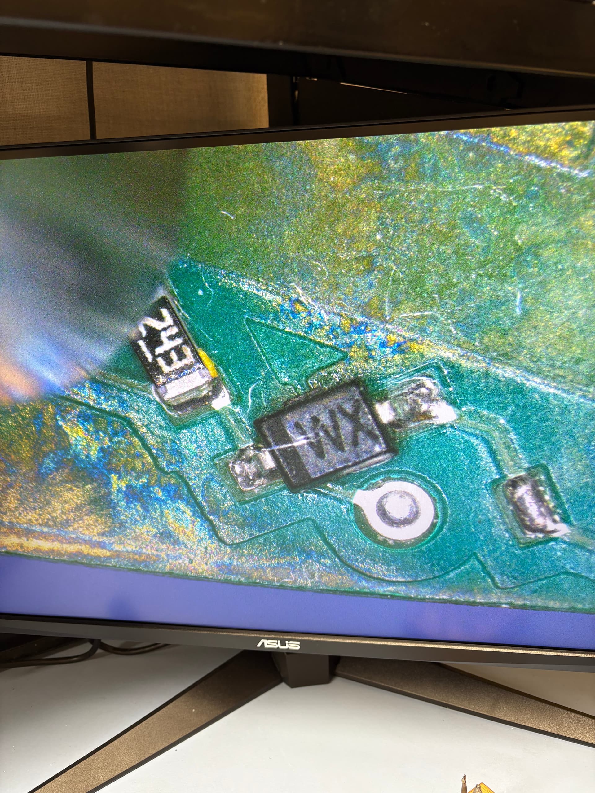

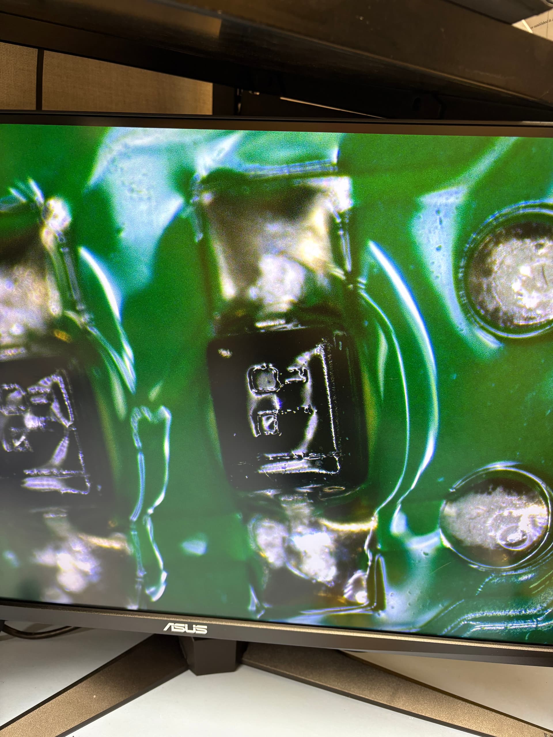

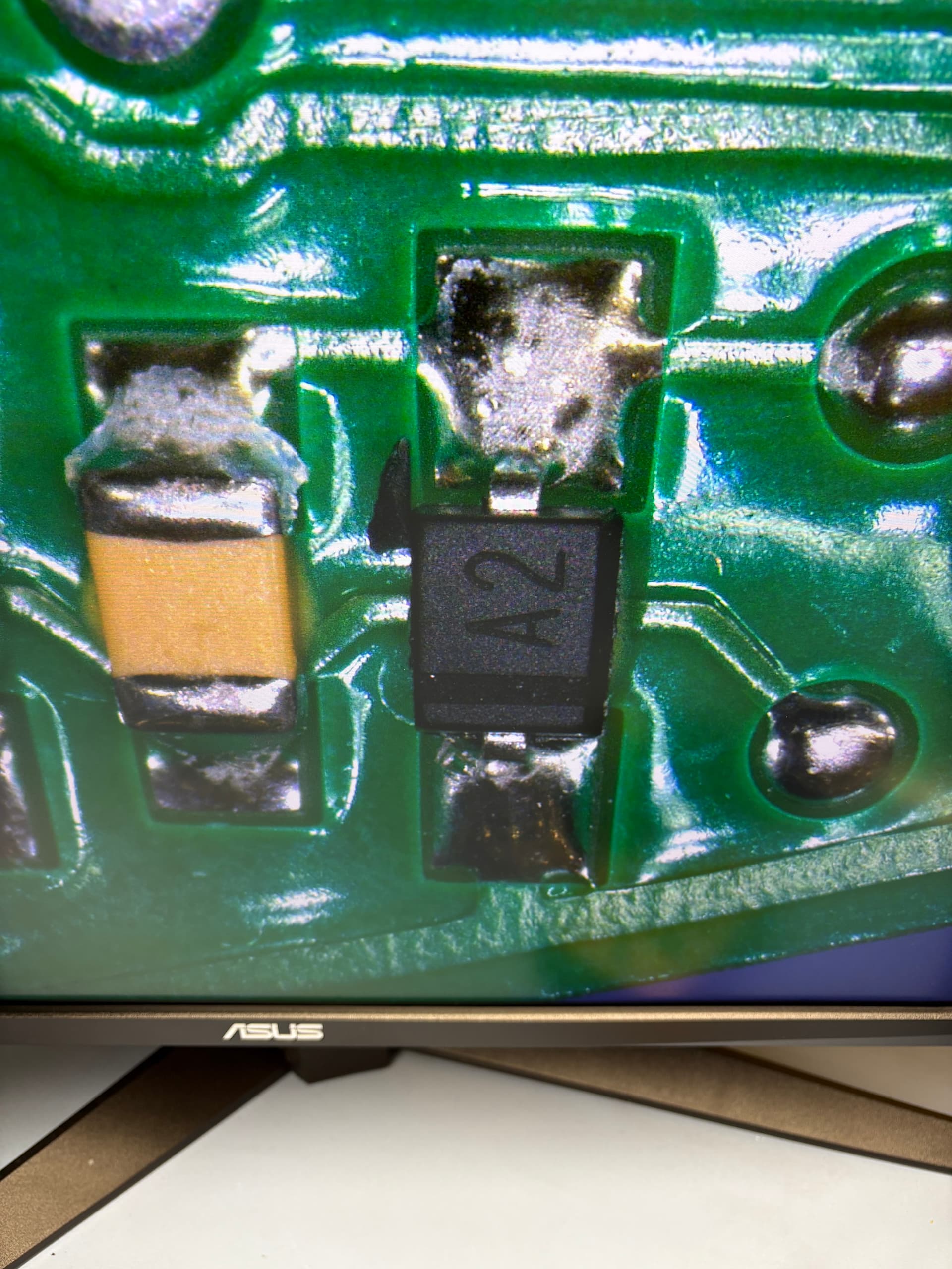

Could I get some help identifing these three diffrent diodes? They are all 2mm long by 1.25 mm wide. Surface mounted componets. Below is the voltage measured for each of them.
198: .743 V
WX: .733 V
A2: .615 V
Any information would be greatly appreciated.
Add images
Hello kenneth.hillen
Need a clear photo of 198 without lacquer.
Check this one:
WX - BZT52C2V4
A2 - 1N4148WS

I was not able to find anything for the 198 chip just like Adam7 suggest if we could get a clear photo without the lacquer it may help in finding that chip
For the WX I had found part number BZT52C2V4S-7-F Diodes Incorporated | Discrete Semiconductor Products | DigiKey
For the A2 I had found part number 1N4148WS-AU_R1_000A1 Panjit International Inc. | Discrete Semiconductor Products | DigiKey

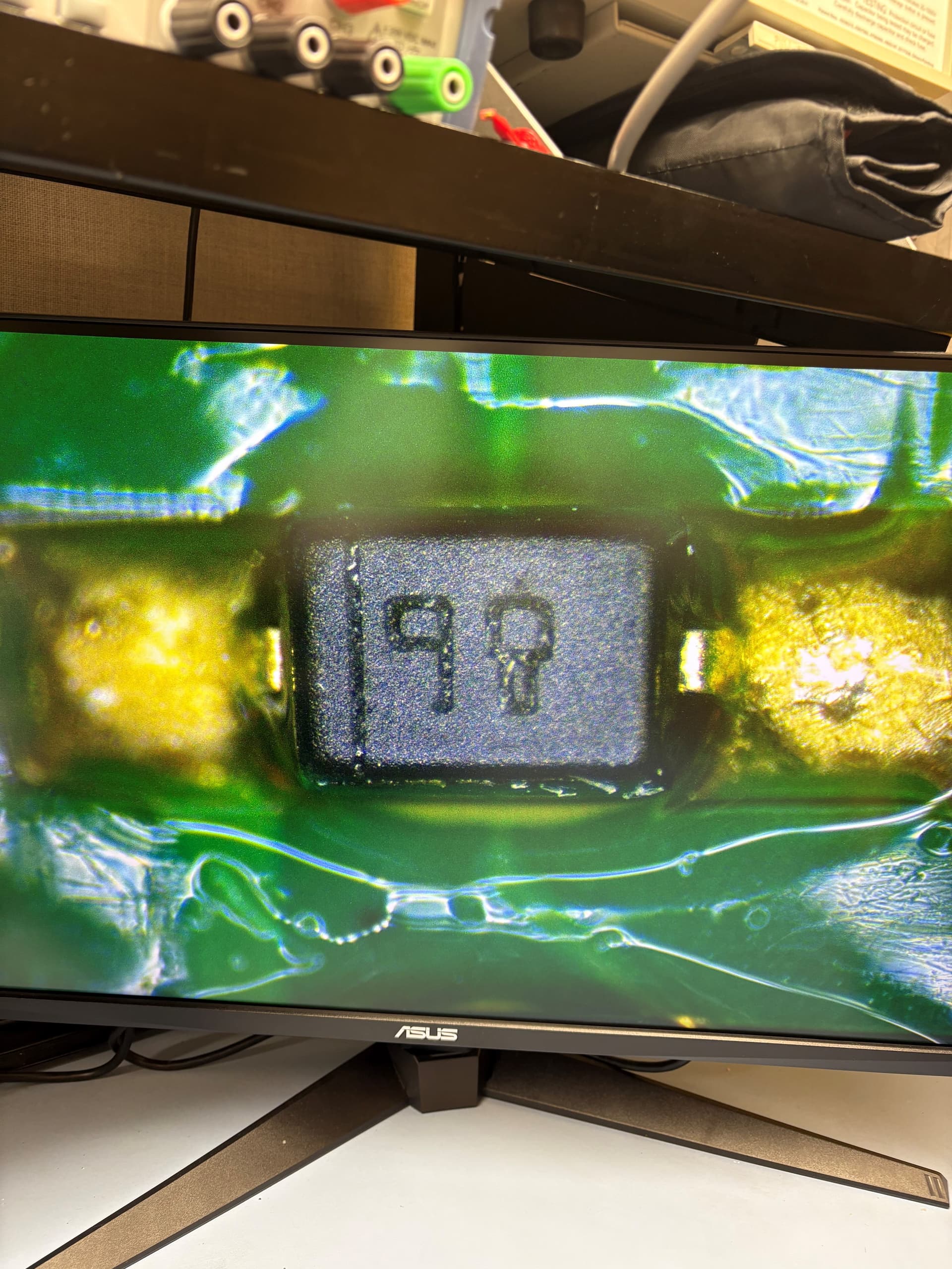

I got a better picture of the 198 diode for you guys. Its actaully not a 198, the diode marking line just looked like a 1. I am assuming the rest is 98, that is the best picture I can get. Thank you guys so much for your help. I appreciate it.
kenneth.hillen,
This is not 98.
You need to turn the photo over and you will see 86.
Your diode (86) is called - BAT54JFILM

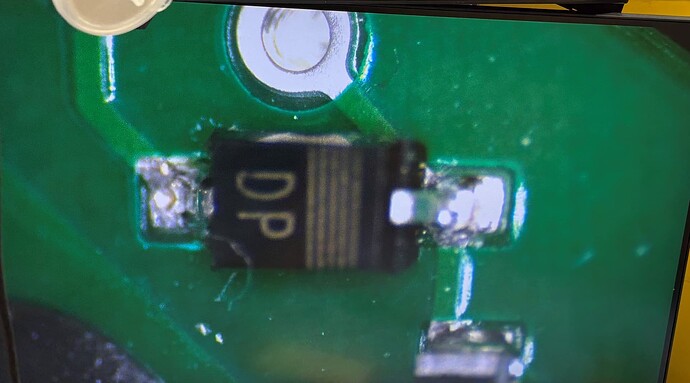

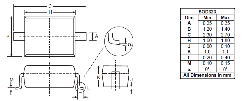

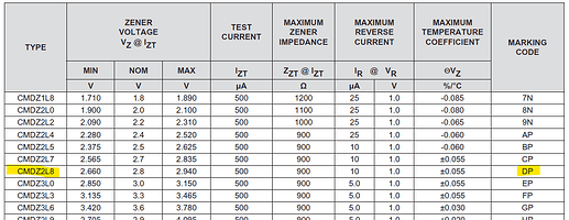

Do you guys think you could help me find this Componet. I think it might be a diode. It is 1.55MM long and 1.24MM wide. It looks like DP lettering on the componet. You guys have been killing it finsing these so this one should be a cake walk.
I would say a diode is right, but I can’t confirm for sure. I’m thinking one of our engineers will have a better idea.

Would some measurments from a multi meter be able to give you some more information?
Hi kenneth.hillen,
Those dimensions indicate an SOD-323 package just like the CMDZ3L0 mentioned above. From the same datasheet, the CMDZ2L8 TR PBFREE has the “DP” marking:
The CMDZ2L8 TR PBFREE is no longer available. The nearest part we have in stock at the moment in the same SOD-323 package is this one:
  • PZU2.7B2A-QX with a zener voltage rated between 2.65V and 2.9V

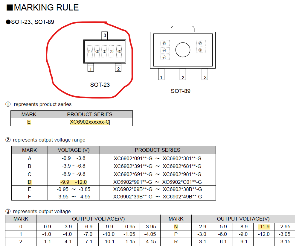

Do you guys think you could help me find what this is? I think it is a diode but I am not sure. It is a very small componet.

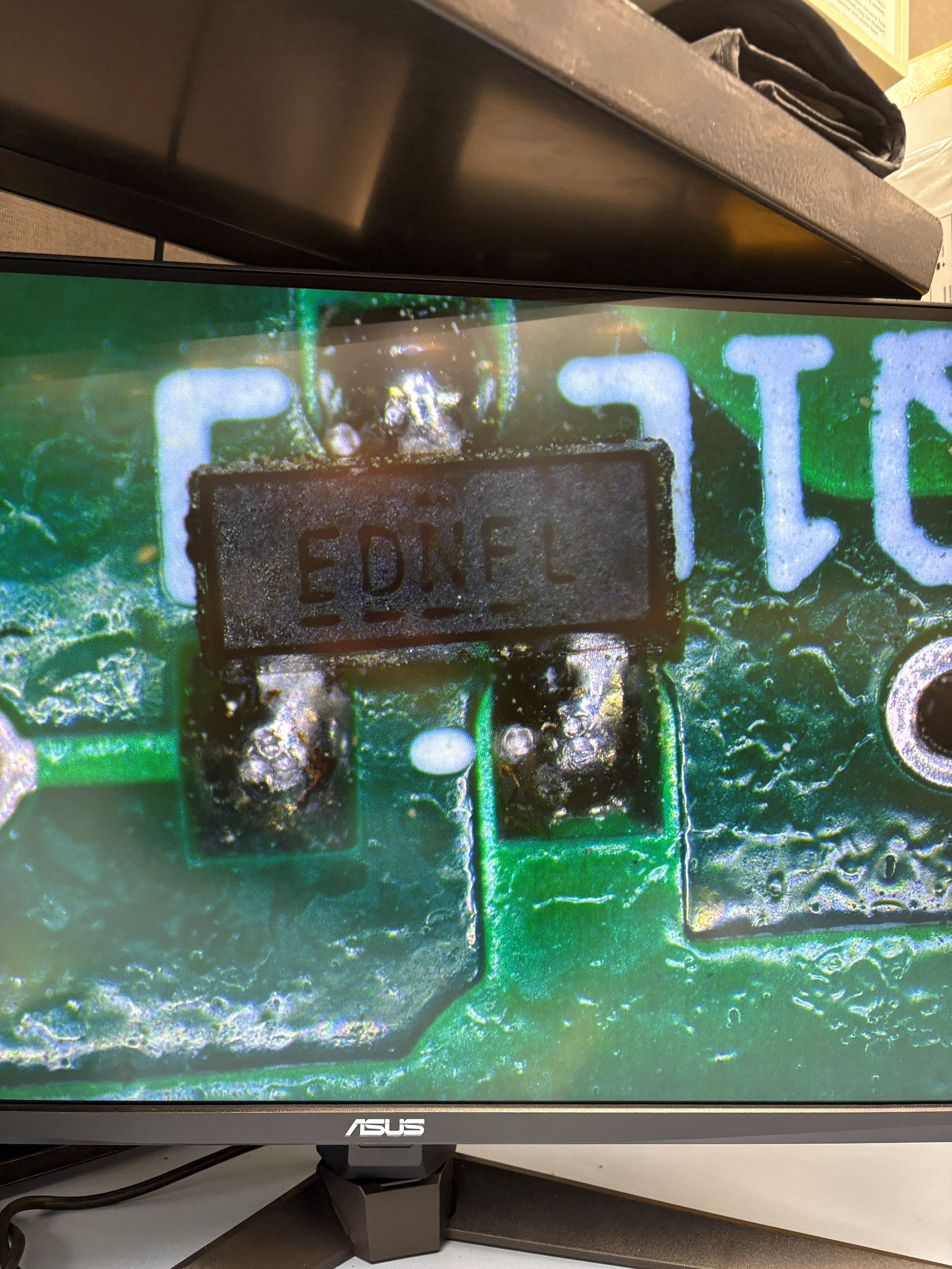

Do you guys think you could help me find this componet? It is very small and I am pretty sure it is a Diode. Thank you guys so much you guys are really good at finding this stuff.
Hello, Kenneth.
This looks like an SOT-23 part, more likely to be a transistor or similar device than a diode. Unfortunately, the ‘EDNFL’ marking code doesn’t work as a whole or in part in any resource I can find. I’ll look into it and see what I can find.
Is that a “Q1” designation next to the part? If so, that means it’s a transistor. Unfortunately, I’m having no luck with this one.

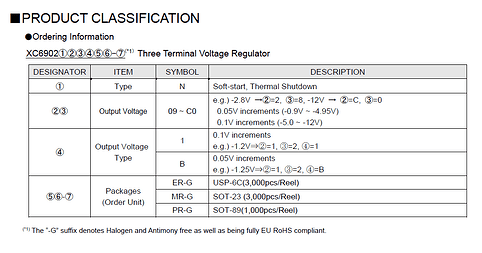

EDIT: However, if it is not “Q1” or if they are not using standard designations, then it could possibly be the following:
XC6902NB91MR-G → Torex negative voltage regulator → -11.9V
See datasheet pages 2 and
Page 2:
Page 18:
A part like this would typically be used to provide the negative rail for an op-amp or some other device needing near -12V.
We do not list this particular part number in our system, though we do list the -12V version:
The only part that we stock which is remotely similar is the following:
  • XC6901DC01MR-G Torex SOT-25 5-pin negative voltage regulator → -12V
Unfortunately, it has a different pinout, so would be very difficult to retrofit. In addition to having a different pinout, it also requires a positive voltage on a Chip Enable pin to function.

You are correct that it does say “Q1” next to the part. I do think it is some sort of transistor becuase I have huntron signatures that disply opens at certain gates.
