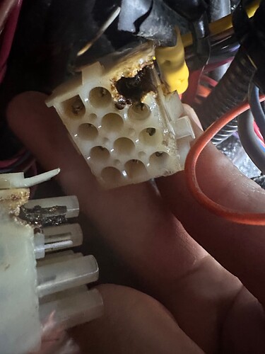

Need help identifying this 12 pin connector
Recently purchased a kit car cobra that was built in the late 90s. Found this melted connector under the dash. I am trying to identify it so I can replace it without having to crimp on all new pins. I’m unsure if it’s a molex, TE or some other connector I’m unaware of, any advice would be appreciated. I would need both the male and female ends and the pin removal tool that fits.
@Bsimms89
A1460-ND was found
1-480708-0 TE Connectivity AMP Connectors | Connectors, Interconnects | DigiKey
A1461-ND is a mate for that
1-480709-0 TE Connectivity AMP Connectors | Connectors, Interconnects | DigiKey
Each do have contacts that can work with them listed on their pages linked above.
Also, The contacts should have tooling listed. If not let us know which contacts you are wanting to use and we will take a look.
