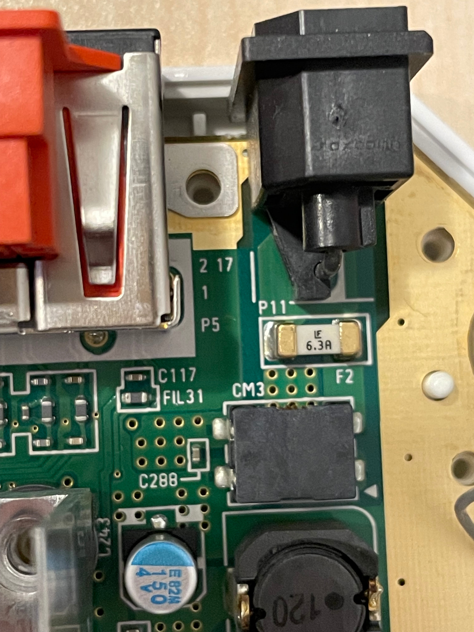

Hi, I’m trying to find a replacement Fuse to fix a Nintendo Wii. It’s the F2 fuse next to the power connector. Based on the markings on the fuse I think it’s a littlefuse brand with a current rating of 6.3A. I measured the fuse with some calipers and it’s approximately 6.1mm x 2.55mm. I couldn’t find too much online about this, but I’m wondering if one of the following fuse part numbers would be an appropriate replacement 045106.3MRSN, 045106.3MRL or 045306.3MR. I’m assuming that it would be a fast acting fuse. In case this is helpful, the fuse is right after the power connector and the power adapter has a input rating of DC 12V 3.7A
Here are some pic’s

I believe it will be one of Littelfuse’s NANO²® Fuses with gold plated terminations.
451 and 448 matches these requirements, and I would recommend the same gold plated caps option(“L”), not “SN” (Sn-dipped Caps).
So, the part numbers would be 045106.3MRL and 044806.3MR.
