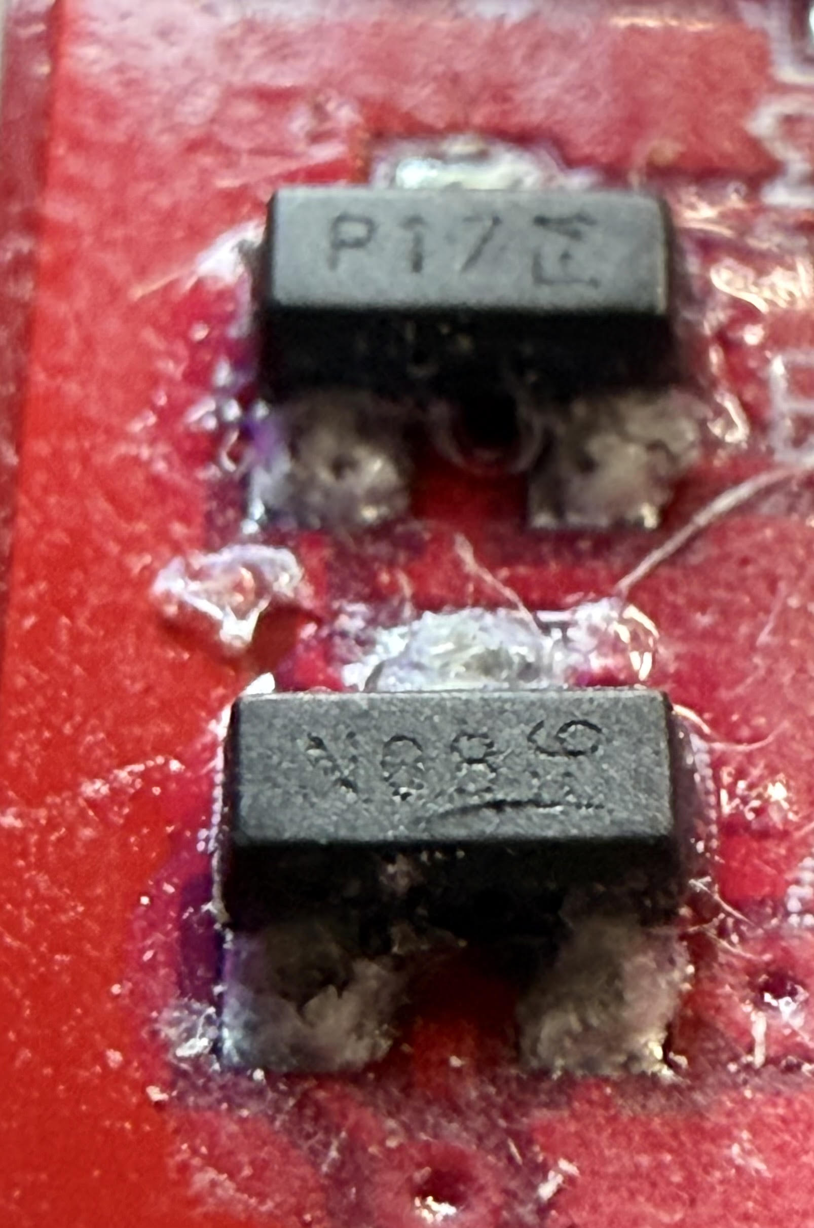

Part identification / Mosfet N
hello I would like to have some help to identify these 2 components. 2 SOT63 package, one is marked P17 and F4 il the logic for me its a P channel mosfet with a GS resistor integrated of 43Kohm, driving a 18/24 volt signal. The other component is marked N08 and F6. for me a N channel mosfet with a GS resistor of 10Kohm. this component is drive directly with µP 3.3v Signal. the drain drive directly the first component without any additional resistors.
In that schematic i have selected 2 mosfet Q7/Q8 but their internal GS resistor is not matching and i add a 43K GS for Q8 and Q7 have a 100K.
Is somebody could help me to find the right ref ? or give me on direction. :slight_smile:
thx
Hi debou7001,
Check this one:
P17_xx - DDTA124EUA-7-F
N08_xx - DDTC143ECA
thank you so much, after checking it could be the right parts that i need. may i ask you if you can help me to identify 3 more parts first one is a diode with 2BJ. second one is U5U Q4? and last one is M13E could be a 3.3 voltage regulator.
thx so much and best regards.
I’m not having any luck finding information on those three markings, unfortunately. Is there any possibility you know the specifications or have access to any kind of schematic?
I’m also not having luck finding these parts based on their markings.
