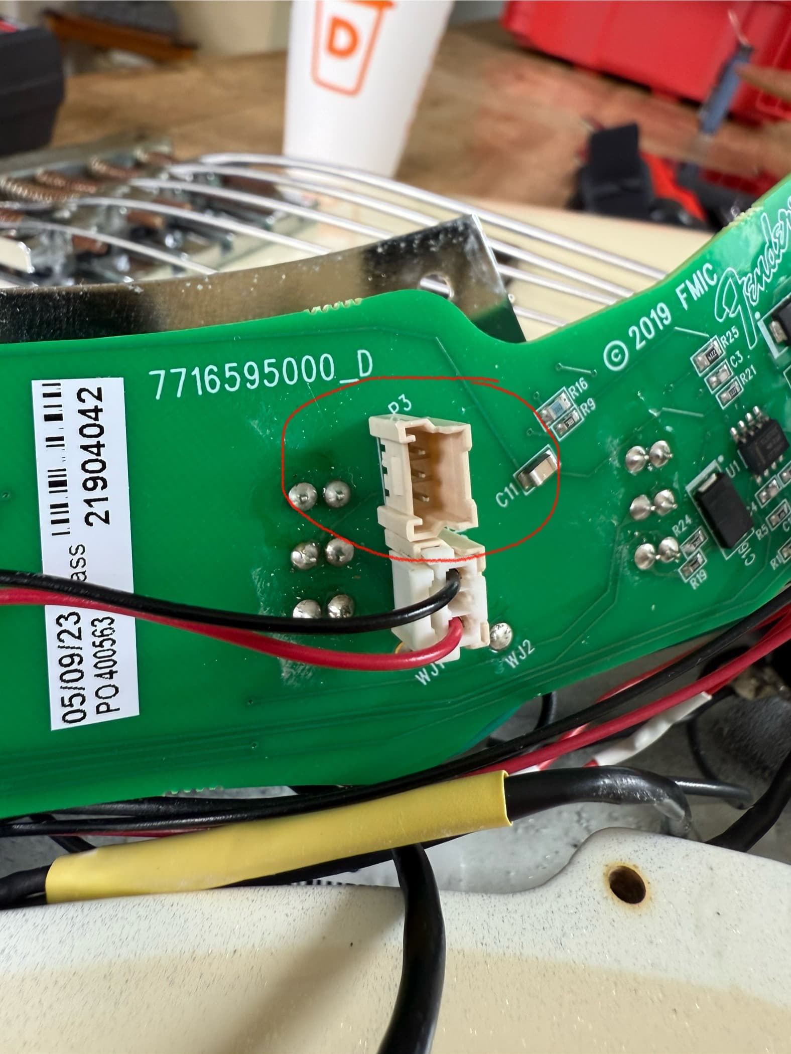

Can anyone please help me find this part?
Do you have any other photos of this part? What is the pitch (center-to-center) spacing of the connector?

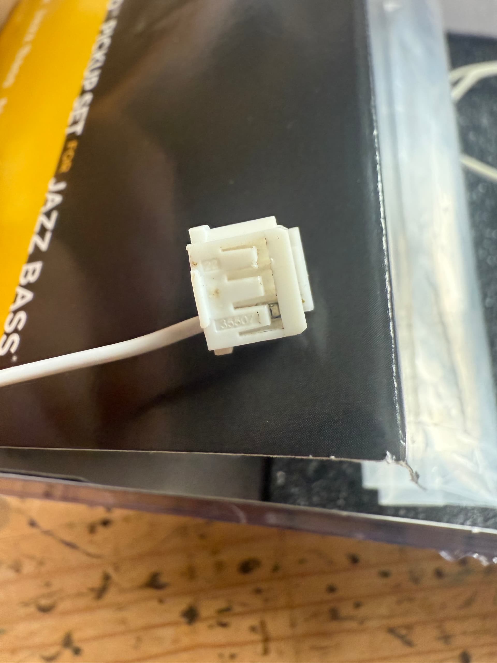

Here’s the other part of the connector.
I believe the connector is WM5982-ND. And, the crimp contacts are here.

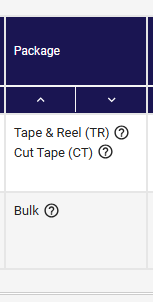

Wow this looks to be correct. Thank you so much Jeff. Quick question, the link for the crimps has two different options. Do I need both or what’s the deal with that?
There are 2 different packaging methods.

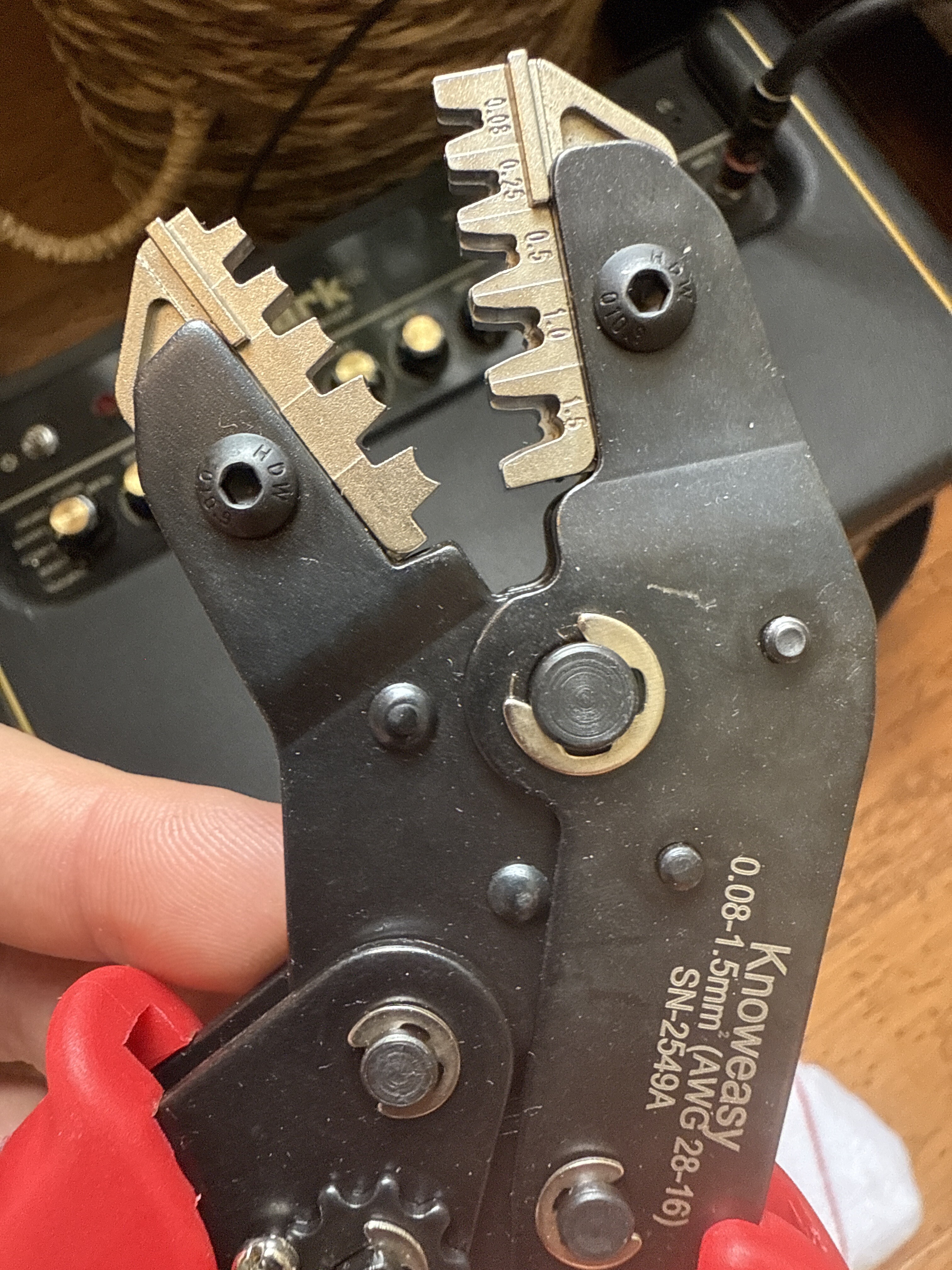

Will this tool work for me?
I don’t think this tool is gets small enough to crimp these little guys.
I would recommend using the manufacturer’s recommended tool WM9027-ND. I can’t tell if the tool you have using a larger AWG wire in the contact would provide a quality crimp.
I agree with you $400+ is crazy expensive
For non-pro use you could try your current Knoweasy crimper. It may work well. Or alternatively get a hobby-grade specially for small crimp contacts.

Hi Jeff I was curious if you had the other end of the JST connector? Here’s a picture of it.
Hello jsmiles930,
I believe the board mounted connector is WM18921-ND.
The picture is just a representation. To see the actual connector, Click on the 360° view.
This is a 3pos connector, and will mate to the WM5982-ND connector.
Wow that’s it! Thank you so very much David.
You’re welcome.
