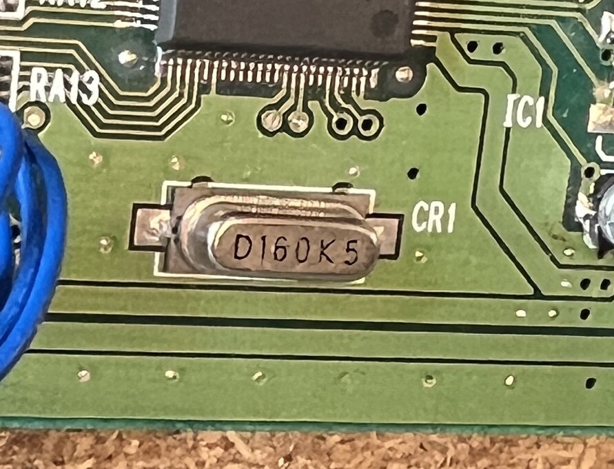

Would someone be able to confirm the specifications from the markings on the attached crystals?

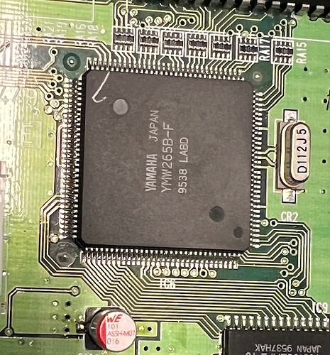

What is the name of this microcircuit?
That’s a Yamaha YMW265B-F 9538 LABD

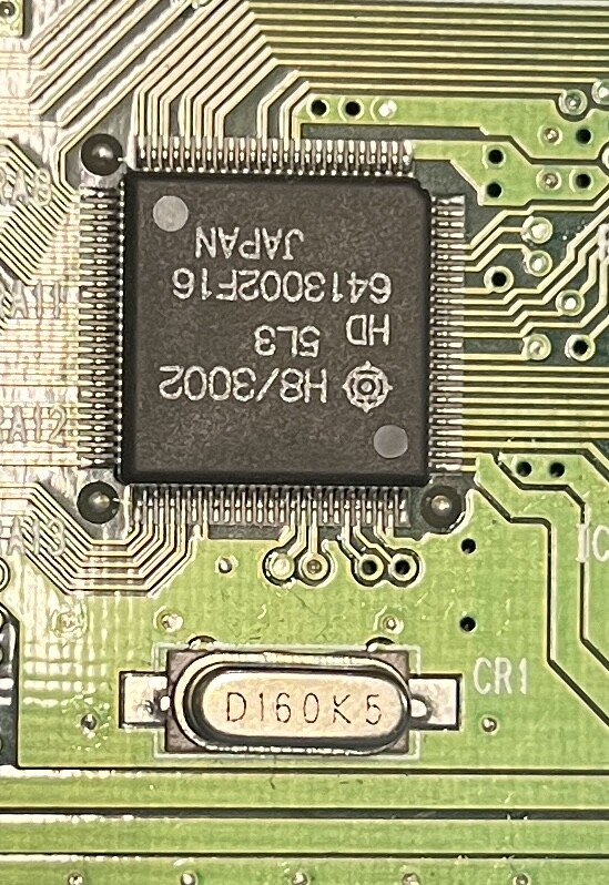

The other crystal is beside a Hitachi H8/3002

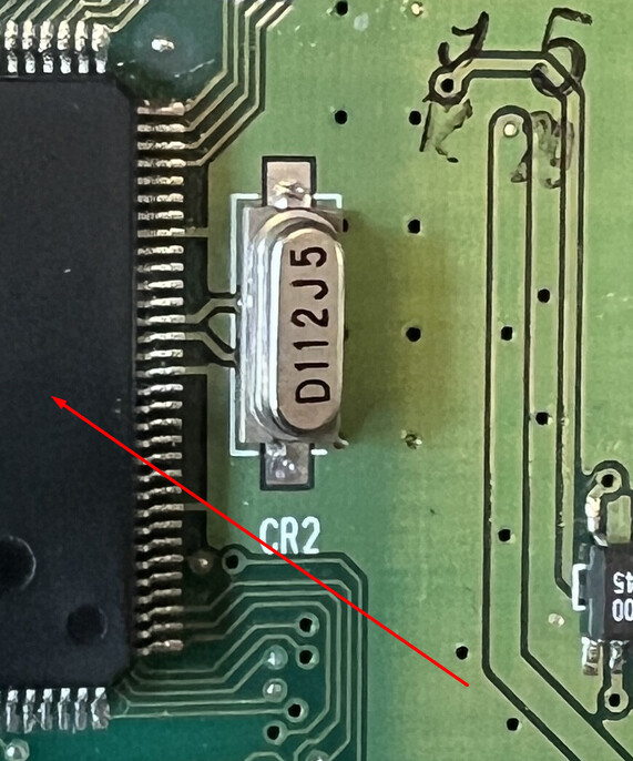

Quarz Crystal marking as D112J5 is 11,2896Mhz (SMD-49) Part № VP864800
Quarz Crystal marking as D160K5 is 16Mhz (SMD-49)

I found the 4981-QT49S-11.2896MAHJ-TCT-ND for the 11.2896Mhz value and also being surface mount.
QT49S-11.2896MAHJ-T QST | Crystals, Oscillators, Resonators | DigiKey
Awesome!! Thanks all for your help!
I found a 16MHz in the same series so I’m good!
