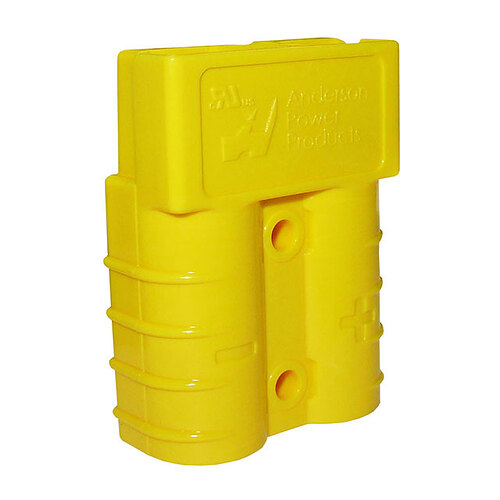

Hello, we want to confirm whether connectors with part numbers 992G5 and 647845-8 can fit with each other or not?
These are NON-GENDER and are both male / female or plug / socket. plugs are cleverly designed that they can plug into each other while keeping the correct battery polarity.
That style of connector has been around long enough to become available from multiple sources. Products of equivalent series and color from the two manufacturers typically do interconnect without issue.
