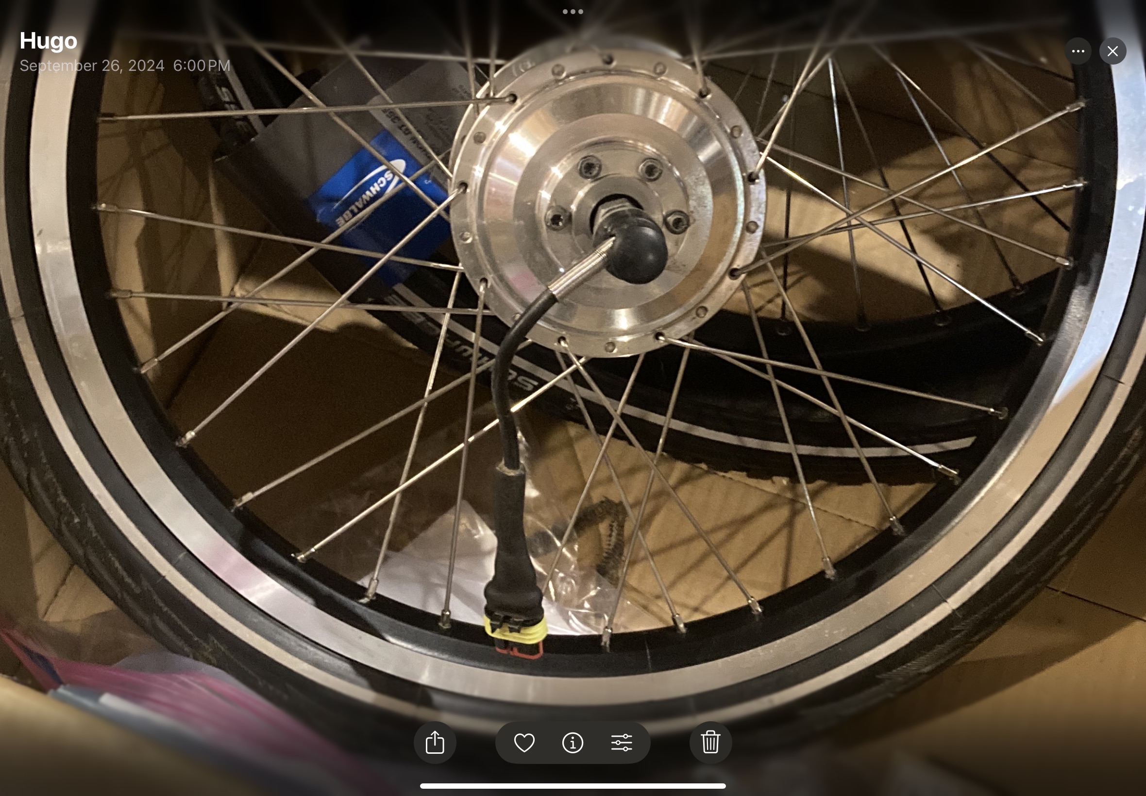

Want waterproof male female plugs only, no cable. I must use existing cable on this bike and plugs/pins must be assembled in existing location. Can’t find product on your site.
It’s a 3 pin cable. Best case would be to find a female plug to assemble for pictured male.
Hello teamdirtbg,
Please see part number A105021-ND
The crimp contacts are available separate. List of options suitable for this housing here. This list can be filtered by the wire gauge you are looking to use.
If you are also in need of the mate I see free hanging option A105023-ND and associated male pins https://www.digikey.com/en/products/filter/rectangular-connectors/rectangular-connector-contacts/331?s=N4Ig7CBcoIYE5QIwA5ECYA0IYBcoBYsAHASyWQDYAGMFAXzqA

Again, you’re going to want to look at the part @Troy_2808 recommended:
Part Number 282087-1
