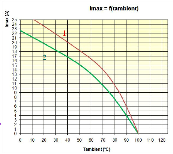

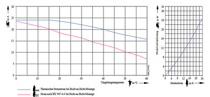

Third, pay close attention to the de-rating curves for these devices as the ambient temperature increases - particularly if using in an enclosed space. The current ratings listed for most SSR’s are assuming they will be operating at near standard room temperature, and must be de-rated as ambient temperature increases.
SUL842770 de-rating curve (see datasheet notes on page 3):
3RF23201AA14 de-rating curve (see datasheet page 6):

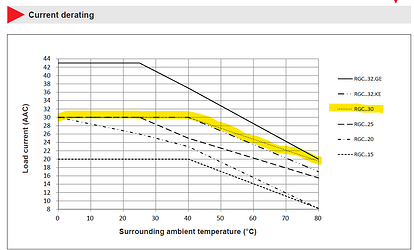

Unless you have very good air flow to maintain an enclosure temperature below 40°C, including the added heat produced by the current passing through the SSR, I would recommend going to a significantly higher current rated part such as the RGC1A23A30KKE, which will handle 20A resistive load up to 80.
Current De-rating vs. Temperature Graph from page 12 of the RGC1A23A30KKE datasheet:
