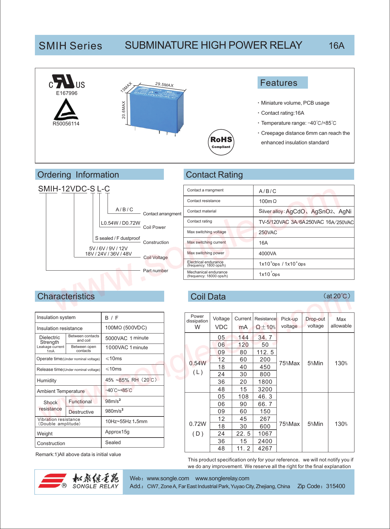

Looking for a replacement for a SONGLE SMIH-12VDC-SL-C Relay for my Kenmore Elite Induction range.
A spec sheet for this part can be found at https://www.rlocman.ru/datasheet/img.php?di=149411
or see below
Thank you!

This is what I am currently looking at on here, will this work?
hesitnite, Welcome to the Digi-Key TechForum.
The relay you found, PB2535-ND, should work as an alternate for SMIH-12VDC-SL-C. They both have the same 1 Form C pin arrangement, same coil voltage, same contact rating of 16A / 240VAC. Also the spacing of the pins seem to be the same, but due to tolerances, may be a little off, but should mount in the same holes from the original relay.
I think you found a good replacement.
I see we currently have only 1 of these in stock, so another option is G5RL-1-E-HR DC12, which is rated for up to 16A / 250VAC, with the same pin spacing/locations.
Technical Reference Number for this information is T4260096
