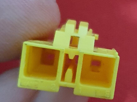

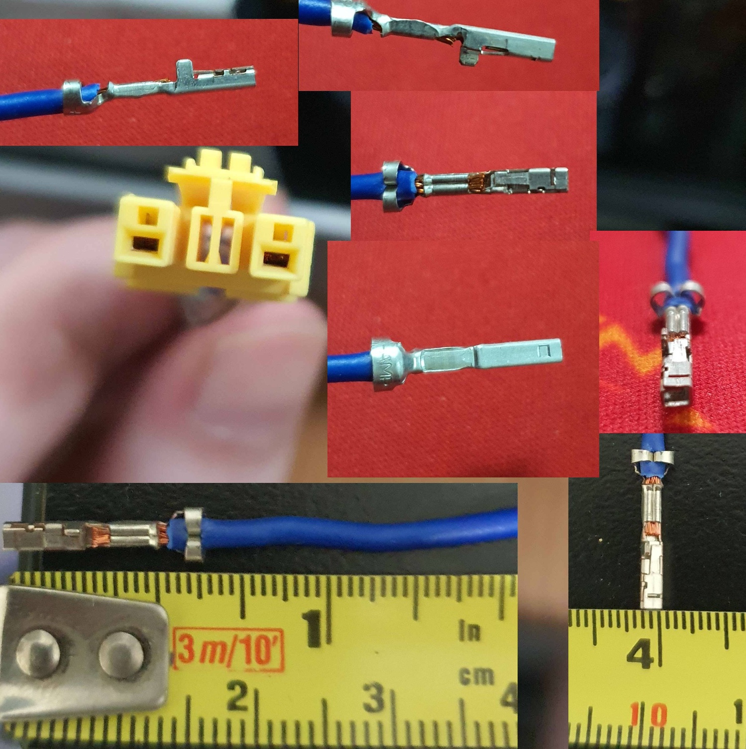

Hi, seeing if I can locate these clampy pins that connect the power wire to the plug that goes into the VCRs power supply. Got it unpinned just fine but then realised I have no idea how to source replacements :smiley:
Included pics of every side of the connector + the plug it sits in.
Model - Sony SLV-E27
Hoping someone can steer me right. Thanks.
Trust me to space out and post the opposite end of the plug, probably confusing people. This is the side the pins slot into :sweat_smile:

Would you have a measurement of the center to center distance for the contact slots?
@bumflufftornado
I found the A122766-ND for the housing.
178125-4 TE Connectivity AMP Connectors | Connectors, Interconnects | DigiKey
Contacts for that.
A100484CT-ND
175152-1 TE Connectivity AMP Connectors | Connectors, Interconnects | DigiKey
Thanks so much for replying :smiley: If I’m doing this correctly (i only have a ruler) the center to center distance where the contacts plug into is 8mm, which checking the datasheet of what you linked appears to be very close.
Appreciate your help! This has made looking for replacement parts far less daunting. I’ll probably post again soon with some more requests and then whip up a big order.
