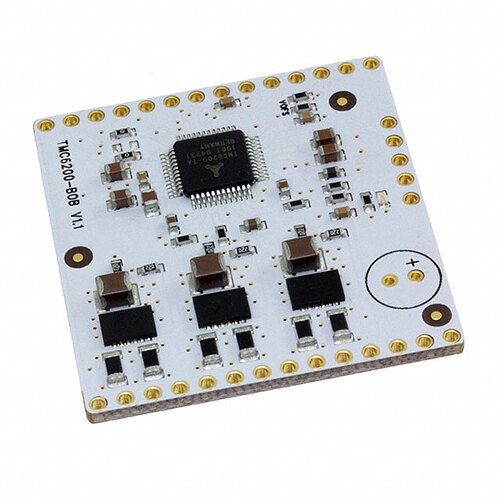

Hello Tech support,
I ordered this board last week. I am stuck now. I can’t run bldc motor with Hall sensor or without hall sensor. I also tried 3 PWM and 6 PWM but result are same.
I am using the
BLDC motor :-https://robu.in/product/42bls02-24v-rpm4000-0-125-n-cm-61mm/?gad_source=1&gclid=Cj0KCQjwhYS_BhD2ARIsAJTMMQa3fRIeOkLKa3jxRdLkna1wXr1qWxtkZHKIGRXdijpC8VOISj8ft5AaAkQzEALw_wcB
MCU :- tried with ESP32 and Arduino UNO
Note: I am not using the current sensor
Please guide me how to solve of this situation.
Thanks in advance.
darshan

Thanks for the reply. The engineers monitor this forum and will see your post. Can you explain your application a bit more with a schematic or more information on how you are using all this together.
Hi Steve,
I connected with ESP32 and TMC6200-bob board
TMC6200-bob ESP32
UH 23
UL 22
VH 33
VL 25
WH 26
WL 27
DRV0_CSN 35
DRV1_SCK 34
HALLU_SENSOR 18
HALLV_SENSOR 19
HALLW_SENSOR 21
ENABLE_PIN 02
VCC_IO 3v3
GND GND
BLDC hall-sensored motor
TMC6200 MOTOR
U U
V V
H H
BLDC motor
+5v and GND
TMC6200
VM voltage 24V
