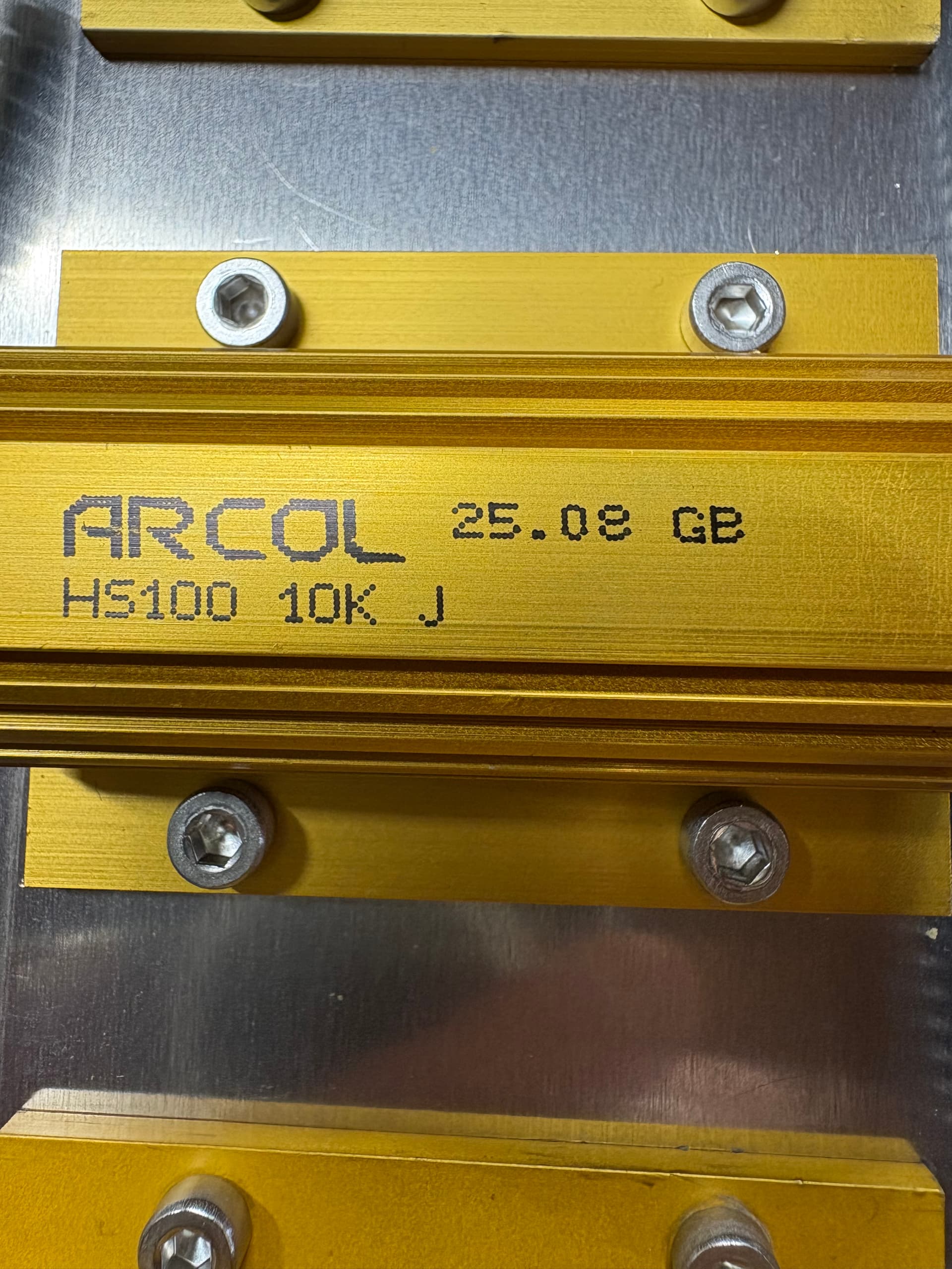

Surface mount resistor, what is the xx.xxGB mean?
Can anyone tell me what the 25.08 GB designates on this resistor? I have an exact match but this number is different on the new one. It isnt listed in the specs, so I assume its not critical?
Thanks!
I’m checking with the supplier to see if they have any details on what that calls out.
It may be just a date/lot code. I would focus more on the part number being the same.
Update: Per supplier
It is the date code it was manufactured and the country of manufacture.
Year 25
Week 8
Great Britain

The “25.08” is almost certainly “year. work week”, so probably “2025, week 8”. “GB” is less obvious, but probably lot code.
