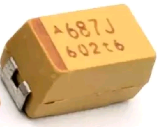

Hello. I need help identifying these 3 capacitors so I can place an order. Thanks you!

687J - 4.31 x 7.4 x 2.77 (mm) or .17 x .29 x .11 (inch)

Interesting. The photos were stock photos. The actual capacitor that I have is 226C rather than 226D. Is it a huge difference? Hopefully this helps. Thank you!

The digits on the top line represent the capacitance value, in picofarads, which is 1/1,000,000 of a microfarad. The first two digits are the significant digits and the third is the number of zeroes following the significant digits.
So, 226 = 22,000,000pF, which is 22uF
Likewise, 687 = 680,000,000pF = 680uF
… and 107 = 100,000,000pF = 100uF

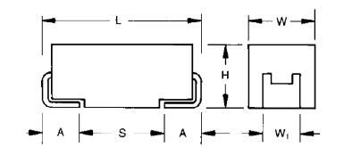

Typically, dimensions are listed as length, width, height, with length representing the distance from one contact to the other, as indicated in this drawing:

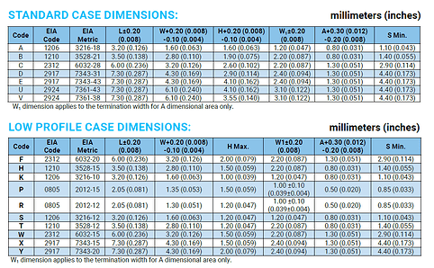

And this table indicates the standard case sizes and their representative letter code designations (not to be confused with the voltage letter designations):
The little delta symbol (or stylized “A”) to the left of the upper digits most likely indicates an AVX-branded product, which has since been acquired by Kyocera in 2020.
Unfortunately, it’s difficult to impossible to know which particular series of AVX/Kyocera tantalum capacitors you have, but here’s a link to possible options for each:
687J → 680uF, 6.3V Probably case size D
107A → 100uF, 10V Probably case size B
226C → 22uF, 16V Probably case B (though case B is typically about 1.9mm high)

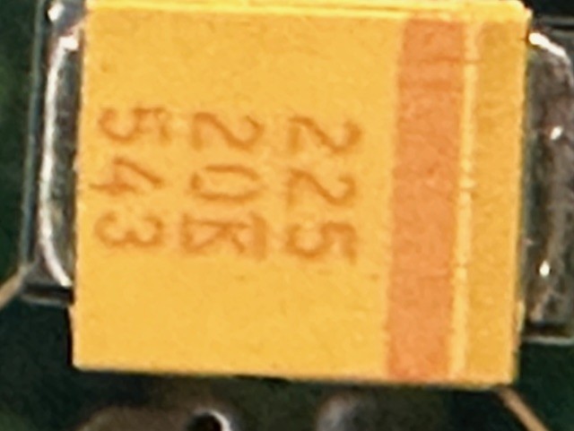

can you please share link to buy this one thank you
Hello absolutely-pc, do you have the dimensions of this part too? It is likely another tantalum capacitor rated at 2.2uF, 20V at 10% tolerance.
i dont have the dimensions
thank you so much for your help
If you get the dimensions, it will help narrow down the choices from this list of potential alternates, click here.
