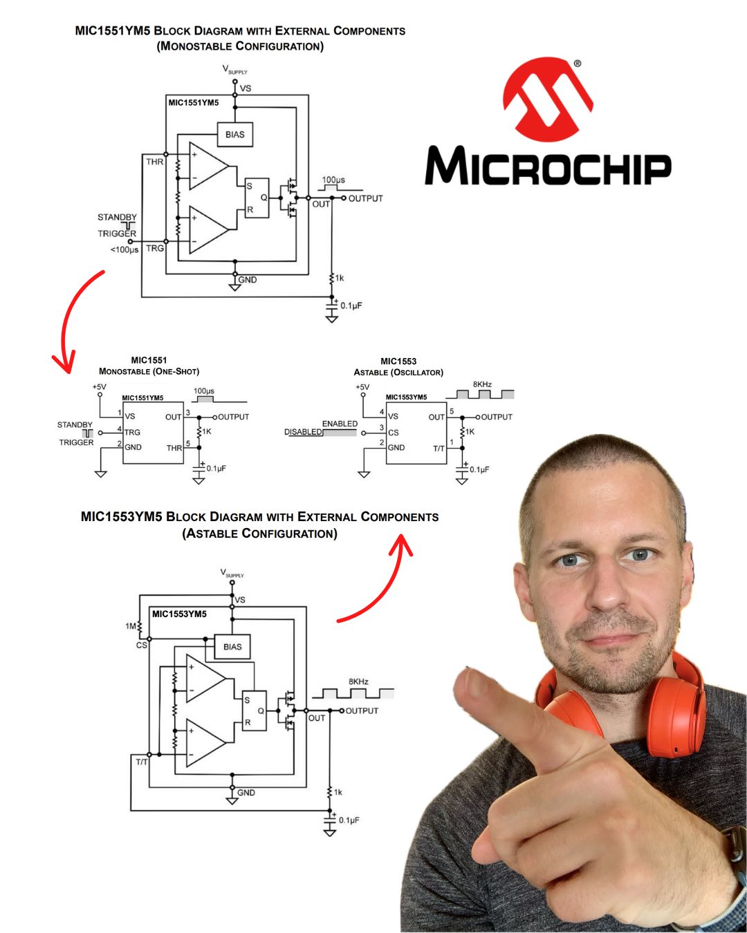

Hello TechForum,
Today, I found the latest addition to the classic 555 timer in the form of the Microchip MIC1551YM5-TR. Thank you Petr Dvořák for sharing this idea (link below).
In the datasheet, they call it the “IttyBitty RC 555 Type Timer/Oscillator”. It is packaged in a SOT-23-5 package and operates with rail voltages as low as 2.7 VDC.

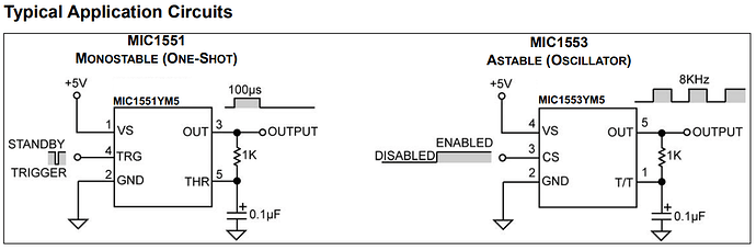

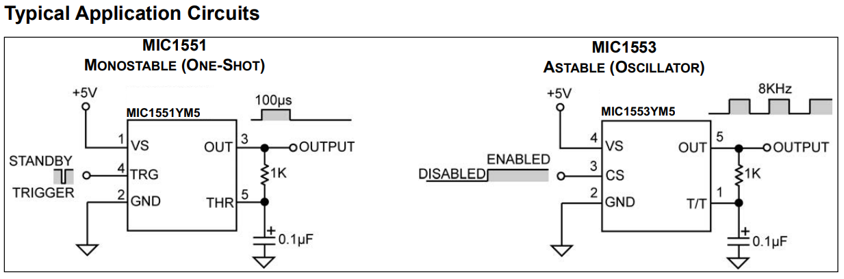

What is the difference between the MIC1551 and the MIC1553?
The classic 555 timer has eight pins while the MIC1551 and MIC1553 have five. Consequently, the smaller devices are somewhat limited in functionality. To mitigate this problem and to simplify the design, Microchip provides two variants as shown in Figure 1:
MIC1551: According to the datasheet: The MIC1551 can be used as an astable (oscillator) or monostable (one-shot) with separate threshold and trigger inputs. In the one-shot mode, the output pulse width is precisely controlled by an external resistor and a capacitor. Time delays may be accurately controlled from microseconds to hours. In the oscillator mode, the output is used to provide precise feedback, with a minimum of one resistor and one capacitor producing a 50% duty cycle square wave.
MIC1553: According to the datasheet, The MIC1553 is designed for astable (oscillator) operation only, with a chip select/reset (CS) input for low power shut-down. One resistor and one capacitor provide a 50% duty cycle square wave.
Figure 1: Typical application circuits for the MIC1551 and MIC1553 as seen in the device datasheet.
