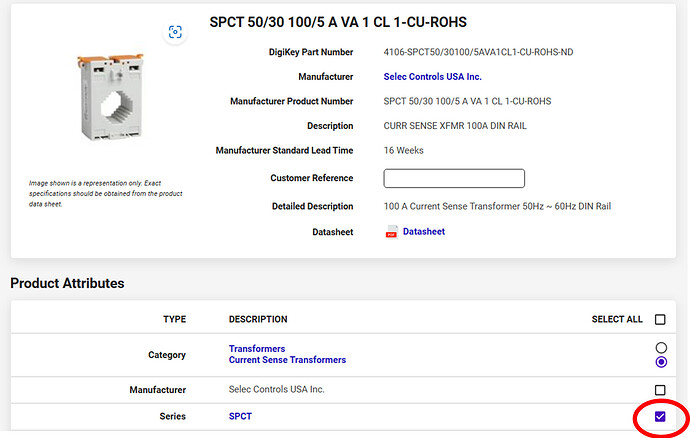

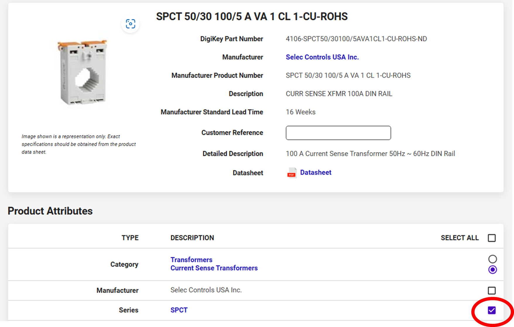

Hello @admin.man,
The instruction manual for the VAF39A specifies a 5A (fixed) CT secondary.
Recommend using a matching Selec SPCT CT. For example, if we assume a 100 A system, the SPCT 50/30 100/5 A VA 1 CL 1-CU-ROHS is a candidate part.
To find related CTs, click the red circled box on the product page. Then scroll down and click view similar. There you will find CT ranging from 40 A to 1200 A.
