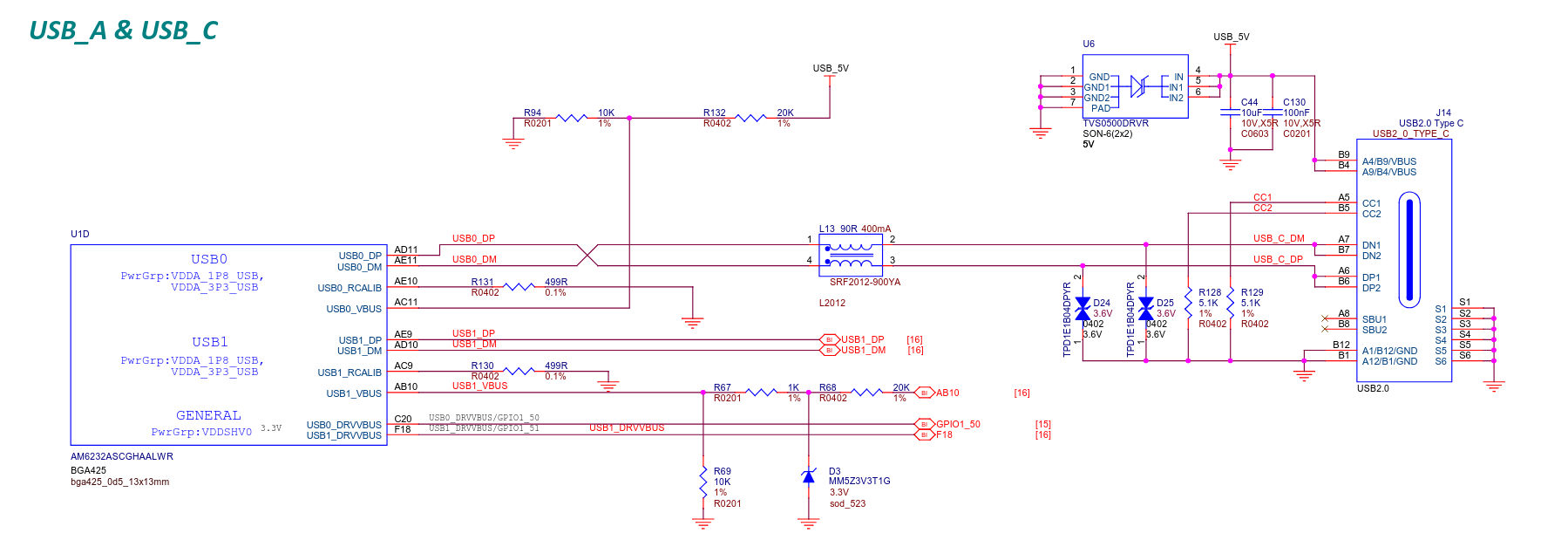

Hi @WilderPumpking76 , what features of Type-C does your design really need? Are you just looking to utilize a Type-C connector and wire up USB 2.0? (allowing either HOST or Peripheral mode?) Or do you want to force a specific wattage?
For reference, here is one design done recently.. Using TI AM6232, where we just wanted USB; so USB 2.0 to Type-C connector:
PocketBeagle 2: pocketbeagle2_sch.pdf · main · PocketBeagle / PocketBeagle 2 · GitLab
Regards,

I need the basics of type c features i.e. USB 2.0 receptacle with no PD (5V 3A).
